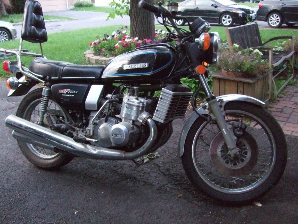

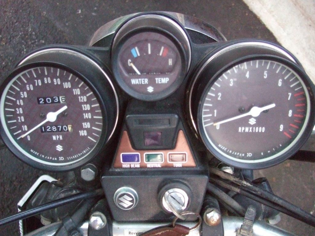

After riding my 74 Gt and now wanting a 77 Gt 750B like I had in 78, I have found a late 77 that is untouched and it has MPH speedo.
It seems this one made it into Canada without the speedo in K's. I wonder if others managed to squeak in
The bike

Thats a very nice find Ian, you've got the bike I'm having to create out of a 75 since I could not find one. The 76 model I've got in Calgary also had on some B model gauges and none of the previous owners admit to changing them.
That speedo was also in mph so its possible those gauges came into Canada as well in mph. Since then its been upgraded to a kmh unit.
Re: Last of the 77 GT 750B's
As Allan says - nice find ! :up: Actually, most of the B models sold in Canada appear to have been fitted with MPH speedometers and KPH units are comparatively rare, and did not appear till mid to late 1977 here - I have some data in the Field Guide at this link. What is your frame number ? My '77 frame number is 80104 so fairly late production (the highest frame we have on record is 80508 in Europe) and it has a KPH clock. 8)

T350guy wrote:Mine is a tad lower at 78463.............This GT is registered as a 78 .
That frame number fits with other Canadian ones I've seen having MPH clocks. Interesting about the registration - the stories these bikes could tell eh ? 8)
Whats always surprised me is why the Canadian Buffalos did not get the dual scale speedo that was used on the B models in the UK.
Probably because even the UK did not get this version of speedo consistently for 77. Some bikes had it while some had the mph only version.

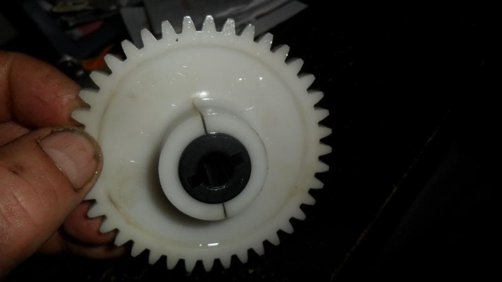

had some time this morning and pulled the points plate off first and the little pin was OK.
Then off comes the cover and I could see a little wear mark in the slot for the points cam shaft..Hmmm?
pull water pump gear and it's cracked..pull starter clutch and the key is good.
Sure glad I pulled it ..Thanks guys :up:
New gear on order from Knalnaarpotz
Thats water pump drive gear is something i am surprised Suzuki didnt improve on over the years as i havent opened even 1 engine that i didnt find that gear cracked like that , the plastic must get brittle over time and when the core metal gets hot during operation it must expand till the crack happens . I have seen special order all metal gears made and home fixes to repair the center section as they do fail .. i had one fail at startup before . I see your in Canada .. its funny some hard to get GT parts here in the US can be purchased through Suzuki Canada , i seem to remember someone in Canada saying they ordered one .
