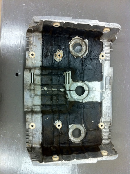

Goop (hard but like hard rubber) on underside of head's ram-air shroud:
Close up:

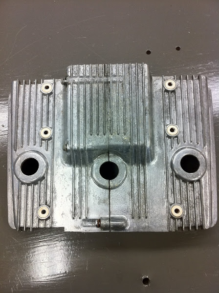

The shiny bits of the motor are covered with a clear coat that has LONG yellowed and cracked. This allows corrosion to go unchecked under the surface and greys the metal.
Here's a shot of the RAM AIR shroud before stripping:
Here's after:
So after seeing the results of a little time with stripper (Tail Stripper II (aircraft stripper) from NAPA), I went after the rear wheel.

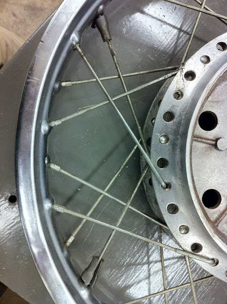

I then went after the front wheel. Here's a shot before disassembly:
The rim is in decent shape, probably due to all the fork oil dripping on it over the years.
Another, just the way it's sat for the last 20+ years.
Spokes removed, post-stripper, hub only:
Other side:
After some polishing.
