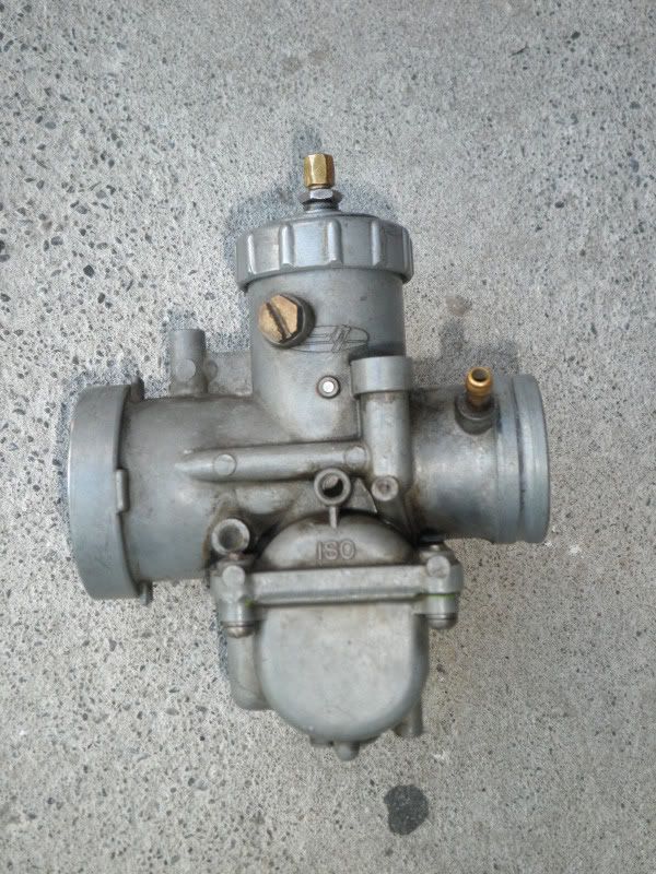

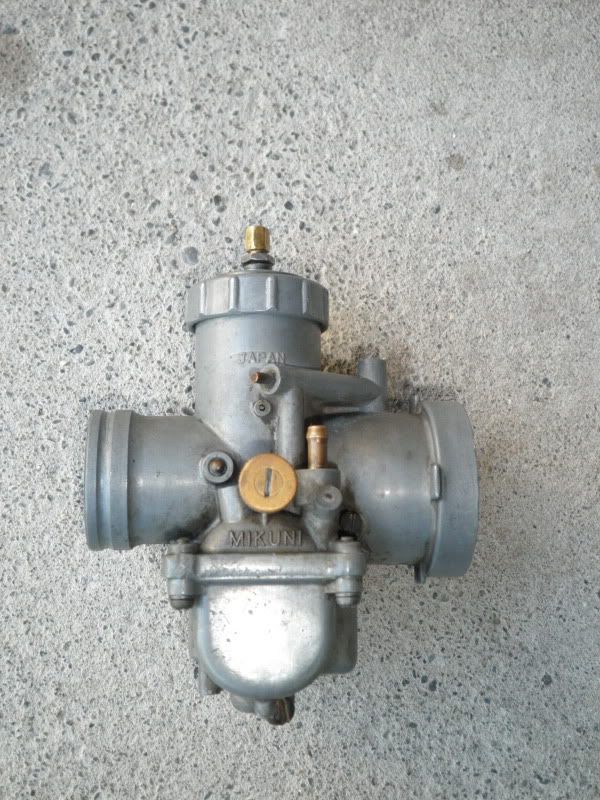

Just wanting to make sure this looks like the correct carb for my J model Buffalo. We have a lot of backyard mechanics down here and it's not unknown for folk to transplant bits to get the old girsl up and running.
Before I pull the carbs apart for a good clean, can anyone confirm this looks correct for the J model? How can I be sure - any marks or numbers any where?
Thanks, Mike

The carburetors are labeled with 316-10L, or 316-10M or 316-10R.
They are already the correct carburetor for your buffalo J
Greetings Thomas
