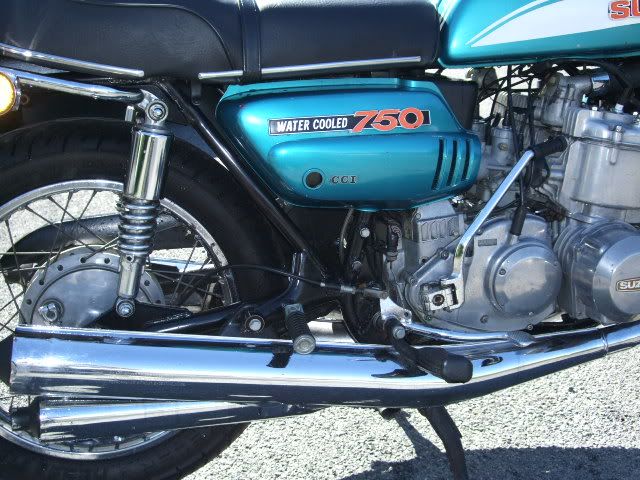

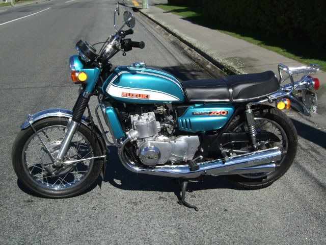

Here are the promised pics of my Buffalo - Waterbus to us down under. So far, I've started her up and was pleasantly surprised at how easy it was, given that she hasn't been run much for a couple of years. I've changed the tranny oil and put new plugs in her. Next step is to change the radiator fluids and clean each of the carbs. After that, I'll take her for a longer ride to get a feel of how she performs.
I bought the bike to restore to her former glory and it seems to me that I have a fairly good starting point. I would deem it a great favour if you guys could now pick her to pieces from the point of what an original "J" model should look like or have on her. this will help me set goals for the resto process.

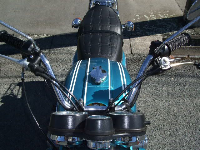

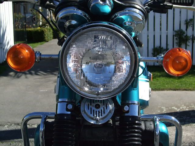

What I have noticed is: Seems to have a later model seat pan with a 72 cover on it, the handlebars are just WRONG :wth:, ? is the headlight correct, ? is the kickstart the correct one, rear footrests seem incorrect, stripes on tank are stck on not painted on...
Thanks for any details/insights, no matter how small.

Can't tell you much about the seat. The handlebars look correct, just angled unnaturally (was the previous owner taller?)..Headlight and kickstart look spot on. Rear footrests are hard to see due to them being down in the pictures....put them up and post a better pic of them plz :)
I have a 74, and the striping on the tank is indeed decals rather than paint.
Honestly, this bike looks very pristine.....there's not gonna be a lot of work on her from what I can see....

Mike you got a 'good one' and for that you should be happy. Its an early version with the carb spigots in rubber and the right foot peg bolted to the rear brake lever.
Ians site is very useful and its got plenty of info, but I think you wanted a 'sort of list' so heres what I see.
The headlamp should have the flat bottom rim, so it appears the bowl and rim are wrong. If stock is your thing it should have a Koito sealed beam unit as well.
The Kickstarter seems to be a later version as early ones were more upright.
The rear footpegs are not correct and they should hold the pipes on at the mount.
The points cover is a later version
The alternator cover is also a later version
The ring on the ign switch should be chrome
Trip reset knob is missing
The colour on the tank badges is wrong
The gear shifter is a later version.
The seatpan and trim is from a later model.
The end cones and seals for the pipes are missing.
Depending on the market region the rear indicator lenses and side reflectors would be red. In others the lenses would be amber.
I cant see if it has on 'S' mirrors or if all the covers are on all of the hose clamps.
Its been a long road for you in your quest, but it was worth it, you have a very decent J now.
