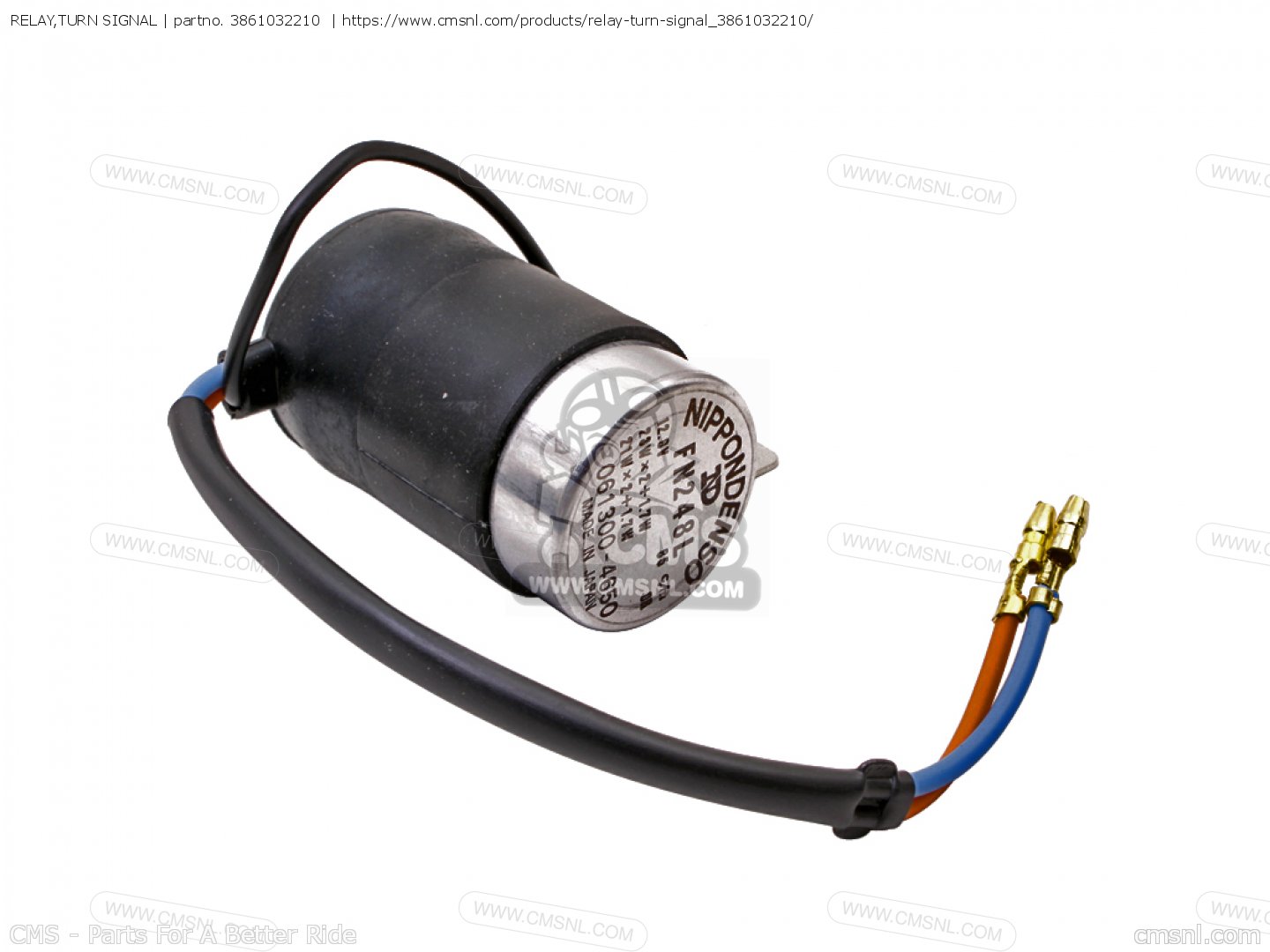

I ordered two pair, they came in, and they look great. Even though I did not specify anything about the two pair, one pair has the wire running through the center of the bolt (yay!) and work for the front, the other pair are slightly different, and the wire exits the shaft before the bolt. That's probably perfect for the rear, since the mounting bracket backs up against the fender and I'm not sure I could get a wire through it. Weird how one pair was different from the other, but worked out perfectly.
Now, I need to get them flashing. Where is the flasher unit mounted? Anyone got a picture? Are replacement flashers easy to come by?
Is this it?
#23 : http://www.cmsnl.com/suzuki-gt380-1972- ... 81490.html" onclick="window.open(this.href);return false;

I normally just pick up electronic flasher units from a local automotive supplier - CTC or NAPA. They cost anywhere between $5 and $12 typically and work just fine. 8)

Scorch, the photo you posted is the flasher relay.

Uh, what's the difference? :lol: Where is the flasher?? The thing I asked about?

+1 - I think the OEM ones are pretty pricey and no one will no the diffence.
