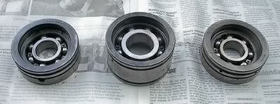

Richard on the T500 the seals sit in the large bearing itself held in by a clip in front of each seal. The only easy solution as was noted is to make a case to hold a modern bearing with the correct ID and press it into this case then fit the seals and clips into it.
Pedro is basically having a complete unit made and they are a lot of bearing when you see one for the first time, looking somewhat in size like a double row bearing as found on many FWD cars at first glance.
I can see his reasoning for this proposal but for the basic Titan owner whos not really going to dump 250 quid for a bearing its an expensive thought.
Pedro i am fully aware of your ideas for this bearing but when you think about economies of scale theres still quite a few T500s out there, AND most persons will buy an old crank and pull it for parts at a pittance of the cost of one new bearing.
For example the other day i bought a T500 crank for about $30.00 dollars (a steal) off of fleabay that had one rod seized on the lower end. Upon inspection the main bearings and the other rod are perfect, so i got 80% of the parts in good shape for spares all for $30.00 dollars.
Its only when this market finally dries up that some people will be willing to do whats necessary to keep a bike they REALLY LIKE running.
If not they will just sell it for parts and move on to another model.
A set of T500 bearings showing the seal recesses, this photo was sent to me by a member a while ago but i cant remember who it was. The centre bearing, in the middle, has this design on both sides as its lubed by g/box oil and not the CCI system.

Allan,
Thanks for the pictures. Thanks for the information.
I can see why it could be an expensive short run job and I can also see that it makes no sense (to me) to replicate that bearing the same way.
Pedro thinks there's a business opportunity and he could be right. I don't know the market that well , but if I were racing a GT and needed a new center main I'd be adapting a stock bearing and getting a sleeve made up.
