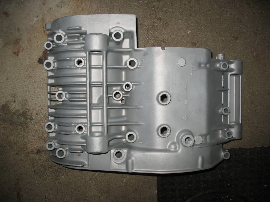

This is what you get from fine media blasting. It's not shinny but rather a satin look and feel. The big plus is it removes all traces of any previous coatings. It gives the surface a great prep for repaint or powder coating as the blasted surface has a little 'tooth'. Maybe someone here knows how to duplicate that original color on the cases but I would suspect that it is not paint. More likely it is powder coat. Put a little paint stripper on a hidden area (underside). If the coating is reluctant to come off, it is powder coating. Blasting removes that as well but takes more effort as it is a lot tougher than paint.
The main cases were painted on a lot of the bikes and since they have fins etc, cleaning this way prior to painting helps prepare the surface properly. This cannot be done successfully without using a blast media process since the casted surfaces are too difficult to reach properly with a brush etc.
Glass beads work well, but do not buy the coarse ones, use #8 or finer grit which gives a bright satin finish.
You mainly want to clean the surface of residue and oxidation plus give it a bit of grip for the new paint to adhere.
Baking soda can also be used if the cases are clean already but just need the crevices working over to reach those areas. It also works great for carbs and fuel taps, but its a weak abrasive cleaner so dont expect it will scour away the gunk on cases.
The case covers always get corroded from age and exposed weathering so its best to use the glass bead media on them first to remove the surface issues and smoothen the surface before working up to a polished finish.
You cannot blast the surface and just leave it, you need to either paint or polish it after as the aluminum surface is now OPEN and it will draw in contaminates faster than before.
As always the air pressure, the angle, and the distance of how you work the gun gives different results so need to pay close attention to what youre hoping to achieve finish wise.
Heres a Titan lower case i was working on so you can see how the #8 glass bead will clean it up prior to painting.
If the cases have some gouges and such from POs bad work or casting issues you can file and sand on them now so once the glass beads are applied it looks tidier.
