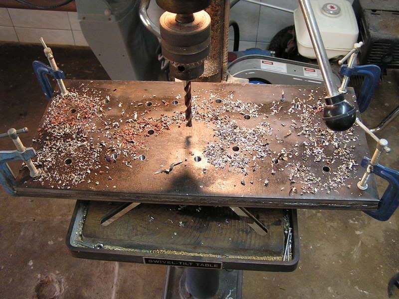

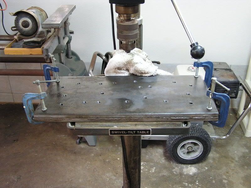

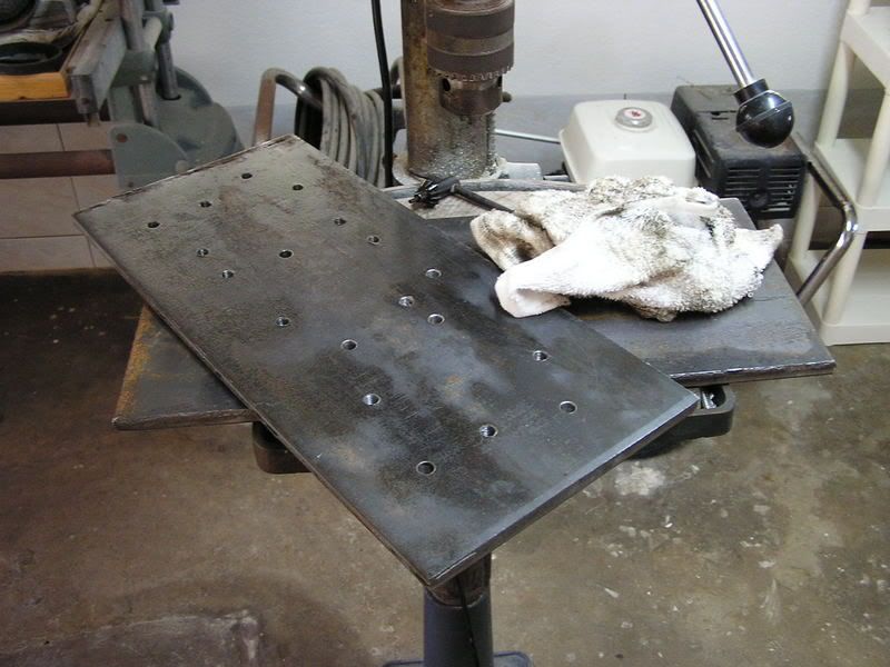

I built two pullers out of 1/2 inch steel plate, one for myself and one for Suzukidave and they work really well.

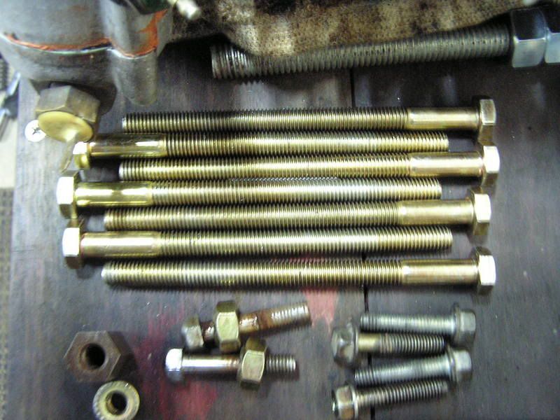

I also chose to tap the holes with a 1.25 pitch metric thread for better stress reduction on the plate and bolts material so the high torque doesnt damage the threads as easy.
These particular bolts have a concave end so it sits evenly on the convex head of the studs and centres itself.
You can use the cylinder head as a hole location guide pattern for marking out the puller plate as well.
Heres a few photos of how mine turned out after making it. There is no photo of me tapping the threads into the plate but they were done as well.

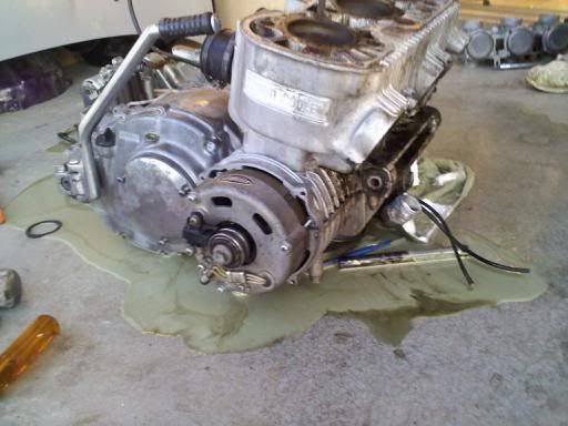

However water can somehow get inside the clutch as in your photo, that looks very bad...dont tell me thats your recently purchased 73 bikes motor.
Suzsmokeyallan wrote:dont tell me thats your recently purchased 73 bikes motor.
Yep - it is the donor engine I plan to use, although I was given this one - possibly needs a bit of oil ....... ? :D Seriously, what I plan to do is just replace all the internals including the crank as its in similar shape, and keep the cases and barrels. Should turn out OK - I'll be posting more info on my web site as the project progresses.
About the penetrant Allan - you are correct. For some of the earlier engines especially I suspect you could let them soak for months and not have much luck :( - having said that I am starting to be a PB Blaster believer as I have had pretty good luck with it so far.
