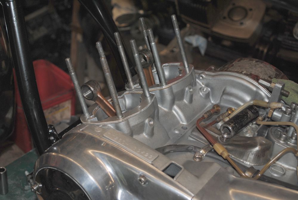

but why would you use brass plate on aluminium barrels? surely it's common sense to use the same material? heat co-efficient and all that, brass holding heat a lot longer than ali? why brass? 3 times the price and a damned sight harder to work. anybody can make anything out of any material with the right tools. we're talking blokes in a shed with the basics. and PLEASE don't slag people off that are just trying to help somebody out. maybe it's no biggie to you, but to me it's job satisfaction and the 4mm aluminium lifter plates i cut out myself using the above method [not having access to fancy tools] and fitted to my gt350 work perfectly
oh, and even though they were done by hand, they look good as well
