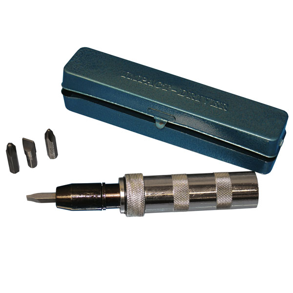

I've never used an electric/pneumatic impact on these screws. I used a hand impact driver. Pick the correct size bit, and hit the back of the driver with a hammer. Easy-peasy.

Buggered up screws is pretty common. The screws on vintage Japanese bikes are JIS, which looks similar but is different to phillips. A phillips screwdriver works adequately for JIS screws that aren’t in very tight, but it will bugger up tight JIS screws like those on your engine covers.
You should get JIS screwdrivers so that you don’t have this problem in the future. I use Vessel screwdrivers, which is a Japanese brand of pro quality JIS screwdrivers. But there are cheaper alternatives.
If your case screws are not too badly buggered up, you may be able to get them out with a Vessel Impacta screwdriver. You hit the end of the screwdriver with a hammer, which forces it into the screw while turning it slightly.
There are also impact drivers with bits that look like this that may work:
You can use a drill to remove the heads of really badly buggered up screws. Once the cover is off, you can use pliers to remove what is left of the screw.

I've pulled apart a lot of motors over 40 years, and can't remember not being able to get a screw out with a hand held impact driver and a club hammer.

another trick is to shock the screws. you need a long screwdriver bit, put it on the screw and hit it HARD with a heavy hammer. this sometimes does the trick, but as titan performance says, i'm the same, i've never failed to get a screw out with an impact driver. mine was about £5 and works perfectly. if the heads of your screws are knackered, then using the blunt bit [in the impact kit] is your best bet. i replace all my cover screws with stainless allen bolts, they are far better and easy to get out - but as has been said before - make sure you put a smear of copper grease on each one WITHOUT FAIL. you'll find having an impact driver in your toolbox is one of the best things you'll ever buy. oh yes, inside the casing there are more jis screws, that might not be buggered, so make sure you've got a couple of jis bits too :D
