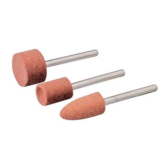

Coming late to this, but I would recommend using jeweller's polishing stones, which you can get from hobby shops or pound shops. All you want to do is take the sharp edge off the port, like Zunspec said. Don't forget to do the sides of the port as well as the top & bottom.
These are the type, just do it by hand using the least coarse stone. The 'cylinder' type works best as you can make a chamfer then smooth it round.

Re: How do you file edges of ports on barrels?
+1 on Craig380's advice. Although when he says "do it by hand" that is without putting it in the drill I believe.

The correct chamfer sizes will be in your service manual. I always used a dremmel tool with little stones like above or better yet solid carbide 1/8" burs http://www.gesswein.com/p-3094-solid-ca ... shank.aspx. Are you sure the shop that did the bore job didn't chamfer the ports?
