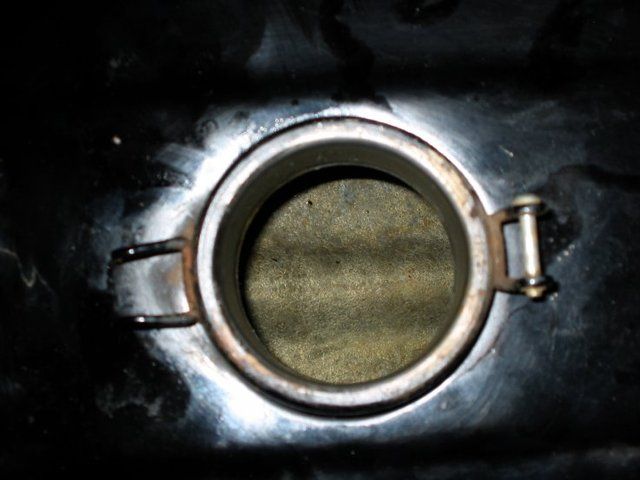

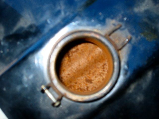

EvapoRust: I give a B. Decent stuff works faster, only goes so far (just like the pic show above)
Metal Rescue: I give a A-... Takes a little longer but does a better final job. looks like shinny metal. fluid become black,,, if some black on metal still use a little more fresh metal rescue... dang it will turn metal to pitted but shinny metal. Dry tank well or left over moisture wil re-rust. Evapo Rust seams a little more forgiving here. These two seam very different: Evapo slippery yellow juice and Metal Rescue look just like clear water
