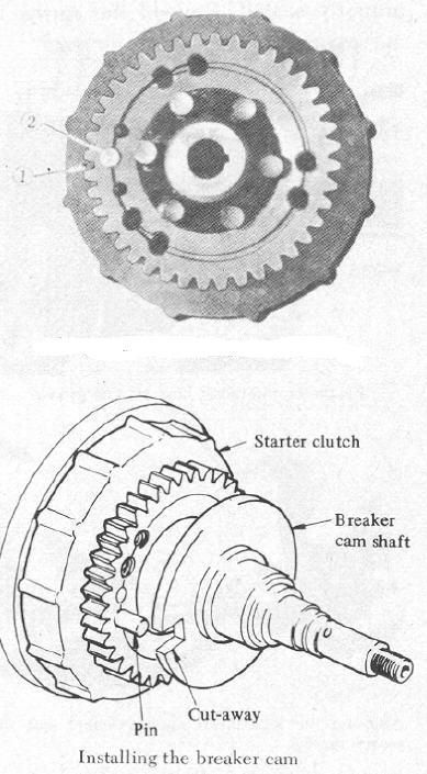

The points cam (and timing marker) is driven by a single pin on the starter clutch. The starter clutch is keyed. If that key shears, the timing plate and cam can be way off. It has happened on here before. You need to remove the left side engine cover to get at it. The starter clutch is a tight fit, but Suzuki provided some tapped holes for a puller. It's my bet the key is sheared on the starter clutch.
And yes,, The timing marks occur before top dead center. In your case. left and right are 3.62mm (.142) BTDC. The center cylinder times at 3.42mm (.134) BTDC. look in the sticky "General specs and info".
Pictured below is the starter clutch and the points cam drive. You can see the key way in the top photo. Numbers 1 & 2 have to do with the water pump drive

Good call on the key. It's toast. I have it timed great in all the wrong spots and runs great. I will put new key in tomorrow and time it again.

Got woodruff key at tractor supply, retimed, and still runs good. Now it runs with the plug wires in the right order.
