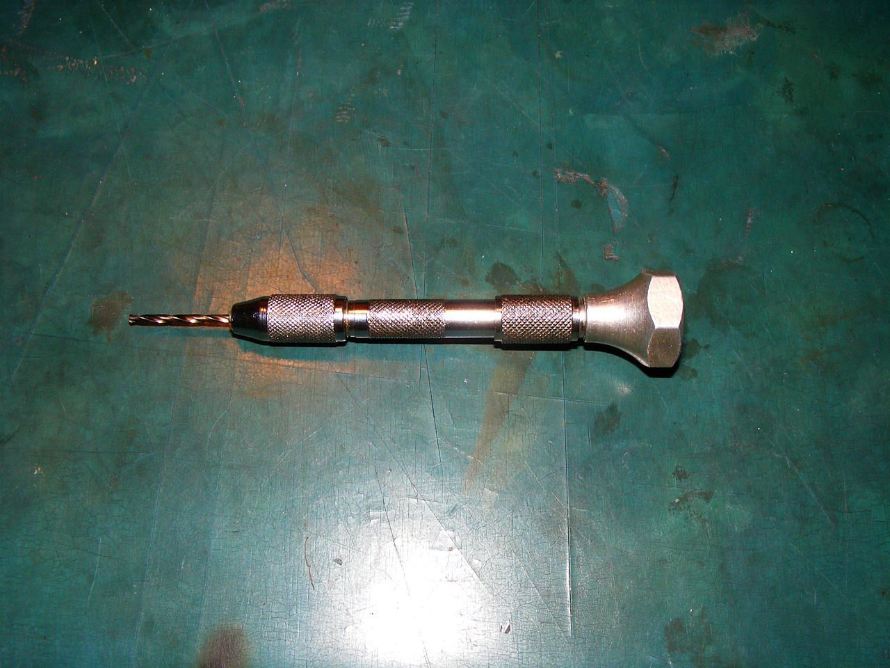

Vintageman, what you need to keep from breaking small drills is a pin vise. Available at most hobby shops, it comes with 2 reversible collets that handle anything from zilch to 1/8 inch. The unused collet stores in the handle. Yes, you turn it with your fingers.

Coyote wrote:pin vise
I had this when I got the bits I need from machine shop where I use to work (miss this) Like you said just use hand motion and feed partial turns reverse an repeat. The drill needed is very small and snaps real easy so go slow.
