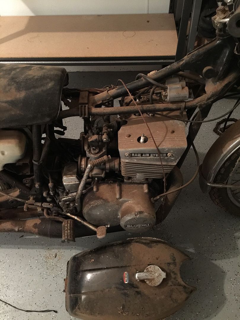

Hey everyone! I'm new to the boards here and new to restoring bikes. I've had a lot of experience working on cars out of necessity, and am somewhat mechanically inclined. I've always wanted to get into restoring old vehicles and I found an old GT 550 in my grandpas barn, figured this is as good a place to start as any.
I believe my bike is 1975. It says 8/74 as manufacture date and lists the vin as gt550-49739 so I think that puts me in the model M category of 1975. The license plate on it says 1988 so I at least know it was last running about 27 years ago!
Anyway, I have no clue where to even start on this bike. I've got a clymer manual and I was thinking of using that to guide me on the "how to", but I'm not sure where to start. Any advice or pointers would be most welcome. Thanks in advance!

We all have different opinions on this.....but for me, I would want to get it running first....if the engine is blown to bits you may feel it's not worth the bother.

Ok, that's kind of what I was thinking too. Get it running first. My question is should I start by rebuilding the carbs? It looks like there was some leaking from some engine seals so should I start by pulling that apart, cleaning and redoing seals?

Welcome to the forum I think the first question is the motor stuck or free. If it is free I would start with the carbs and cleaning the petrol tank. Flush out old petrol . take out the plugs and before cleaning them have a look they may give you an idea how the bike was running before it was stored. Lots of help on here! Good luck

Great! Thanks for the encouragement and advice. I think the engine turns since the chain was moving just fine. I guess it could have been in neutral, but I'll check that out first.

Before you try to start it, lift the barrels off and remove the pistons from the rods, then fill each crankcase with diesel. Turn the engine over slowly on the kicker - lots - then drain/refill/repeat.
This will soften the seals and get a load of crap out of the bottom end of the engine. Make sure all oilways are clear, then use an oil gun to squirt some oil down all the pipes from the oil pump to the engine. Clean the carbs. Then do it again as the first time won't be good enough. Then refit the pistons, barrels and heads and try to start it. You need a GOOD 12v battery and good wiring connections at the very least.

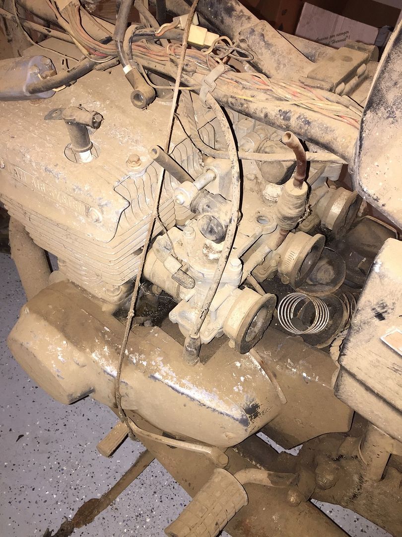

I'm planning on replacing the wiring before getting to the starting point. Just got the carbs off so I will start on those soon. I will need some hard work to get the head cover off as two bolts snapped below the surface with almost no torque on my part. My first try to get one out had my easy out snap off in the bolt. Funny part is when I took the mufflers off they came off super easy. That's funny to me since when I work on cars the exhaust manifold is almost always the must stuck on part.
Good news is the mufflers sound solid, no rattling or loose crap inside!

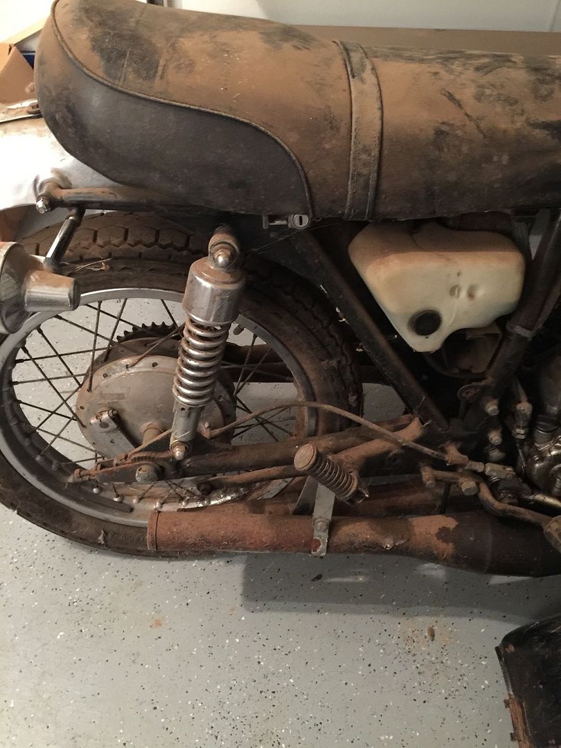

Great pics of the bike! Don't mean to hijack the thread, but can anyone tell me what those two bolts are for in the frame behind the rear brake light switch?? Every GT550 I've seen, including mine has them!
