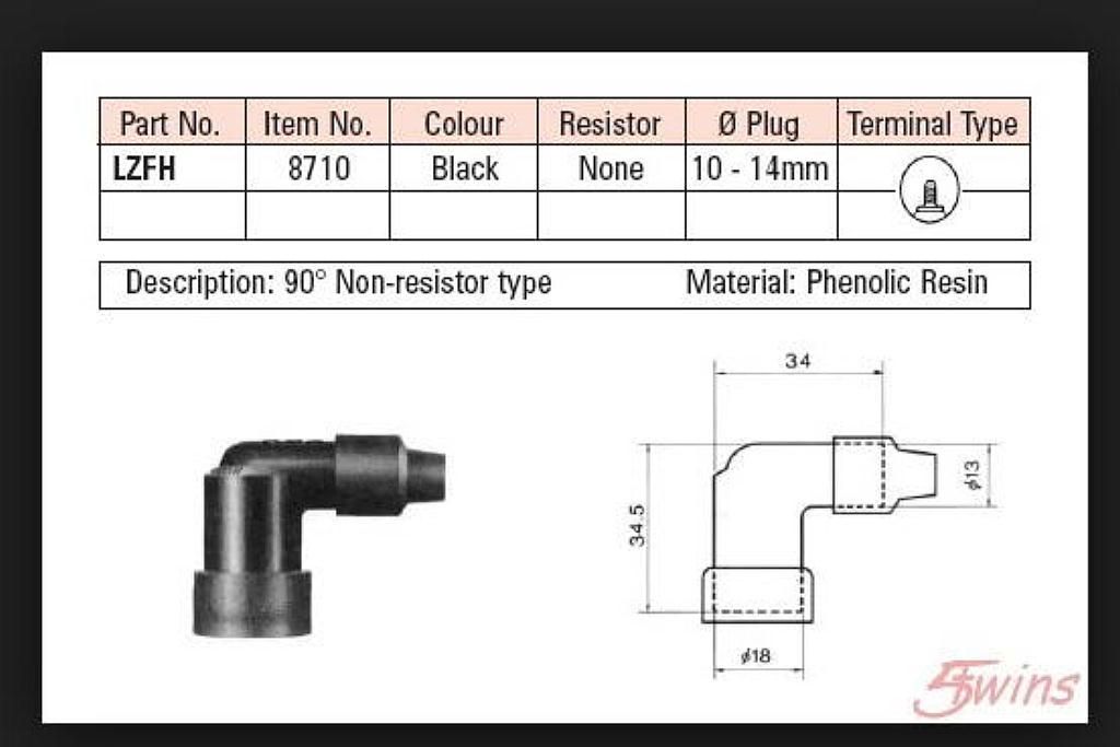

thanks guys,, when I put the newtronics kit in I replaced the coils as well, so I have new coils and electronic ignition, I looked at my plug caps and they have a number on the side ngk lzfh , I looked this up and it says they are resistor type plug caps,, so which is better a resistor type plug or not? I know it really doesn't matter but if im going to a colder plug I would like the best spark I can get which would be no resistor plug right? since the caps have the resistor,, ? again I know it probably wont matter ,,thanks for all the info you guys are great!!
Re: which spark plugs??
You sure you got that right? LZFH is what I run. They are non resistor. You might want to compare dimensions
It's all very confusing. Apparently the LZFH comes in several configurations. If yours are short like the one pictured above, it is a non resistor plug cap. If it is much longer then it is the resistor type.
Also that number 8710 I don't think is available anymore or has been changed. The plug caps I have are LZFH 8381. They are identical to the 8710 above

No number means no resistor. The number in the part is the resistance in K ohms.
Example: LB05E is a 5K resistor cap.
It's the wording that gets me sometimes. I have the box right here. It says: "LZFH. stock # 8381. Spark plug cover". It's a cap but it's called a cover
So you have spark plug covers, spark plug caps and resistor covers. No discernible difference. They all look alike. As far as I can tell, spark plug covers and spark plug caps are one in the same.

Wow, I had ordered my caps and I believe my coils from Hvc cycle a long time ago , I looked up the plug caps and it says resistor , but like was said they have different caps with I guess same model number, some are resistors and some are not . I tried posting a picture of my plug caps but I wasn't able to , the number on my caps is 33u not sure what that is .
- Posts: 280
- Joined: Fri Oct 19, 2012 9:57 am
- Country: U.S.
- Suzuki 2-Strokes: 1974 gt750, 1963 superhawk
Lzfh is by itself on the cap, and then at the bottom of the cap where the rubber boot fits it's the number 33u, So the number is not with the letters lzfh so I guess mine are not resistors , wow sport for something so simple turning into something so difficult , but this has started to become I interesting ..
