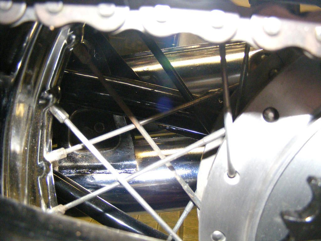

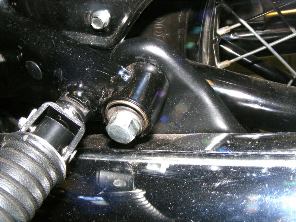

There are no springs depicted on the 72 and 73 fiche. But the hangers do have the cutouts. Sounds like someone has replaced the outer pipes with the later model pipes. The mounts are different so maybe the original mounts were cut off and home fabricated mounts were welded on. There should be evidence of that though. Like old grind marks or welds near the mounts. I think the difference is about 1 1/2 inches. The mounts (hangers) are not stock without the cutouts.

1976. Outer mounts are solid. Inner mounts have the cutouts
