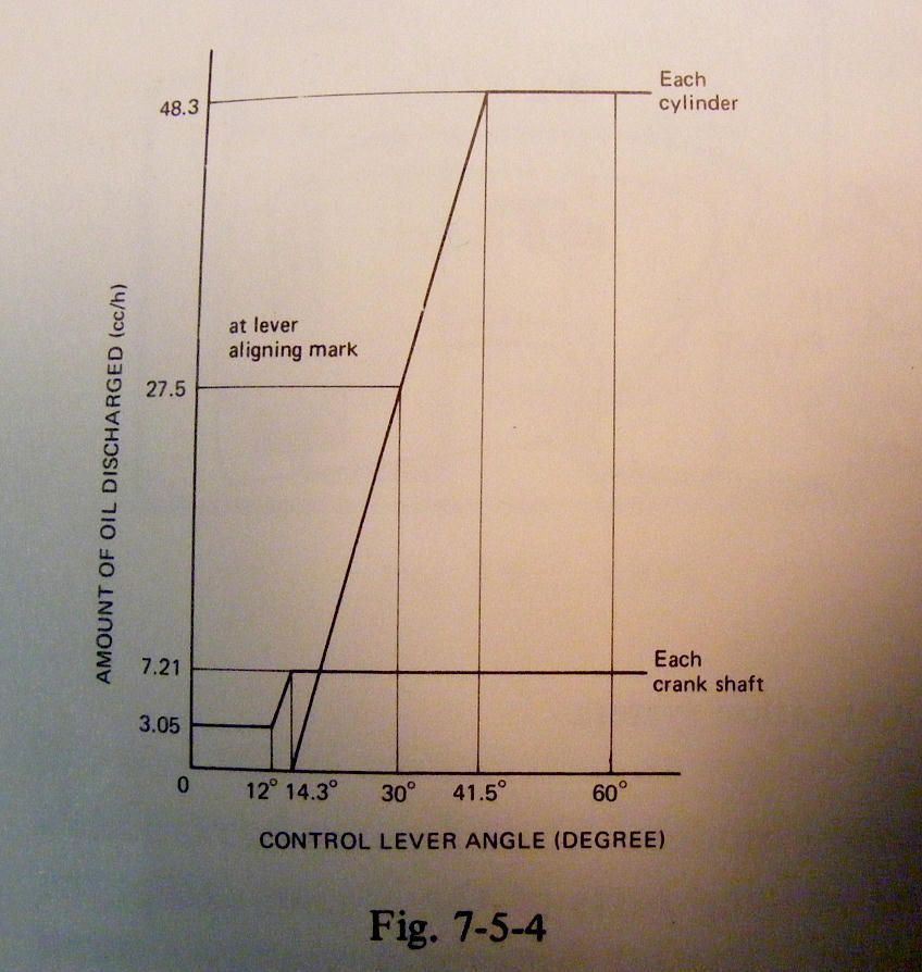

I certainly didn't know this. I found this chart in my Suzuki printed manual.. This is telling me that once the pump arm reaches 14.3 degrees, the amount of oil going to the cranlshaft remains a constant. Anything past that does not increase the flow to the crank. It certainy does for the cylinders, but not the crank.
So from this I assume that holding the lever full open to expedite air bubble removal at start up is pretty much a waste of time as far as the lines feeding the crank. I had no idea that the flow to the crank was a constant. Did you?
I forgot this came from a 550 manual. Odd manual. Printed by Suzuki, it covers the GT550J only. I say that because it has all the info on the twin leading shoe front brake. Zero mention of a disk brake that we all know started with the K model in 73.

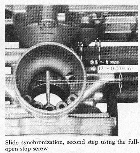

Nice to know. Did not know that. Here's another one. Did you know that the late model 550 and I'm assuming the 380 carbs have an adjustable governor on them ?
Look directly behind the cable pulley on the vertical wall. There's a phillip screw with a loaded spring roughly 20-30 mm long. The further you screw it out. The pulley is restricted from obtaining a full throttle. It's the only explanation I can see for that odd screw.
