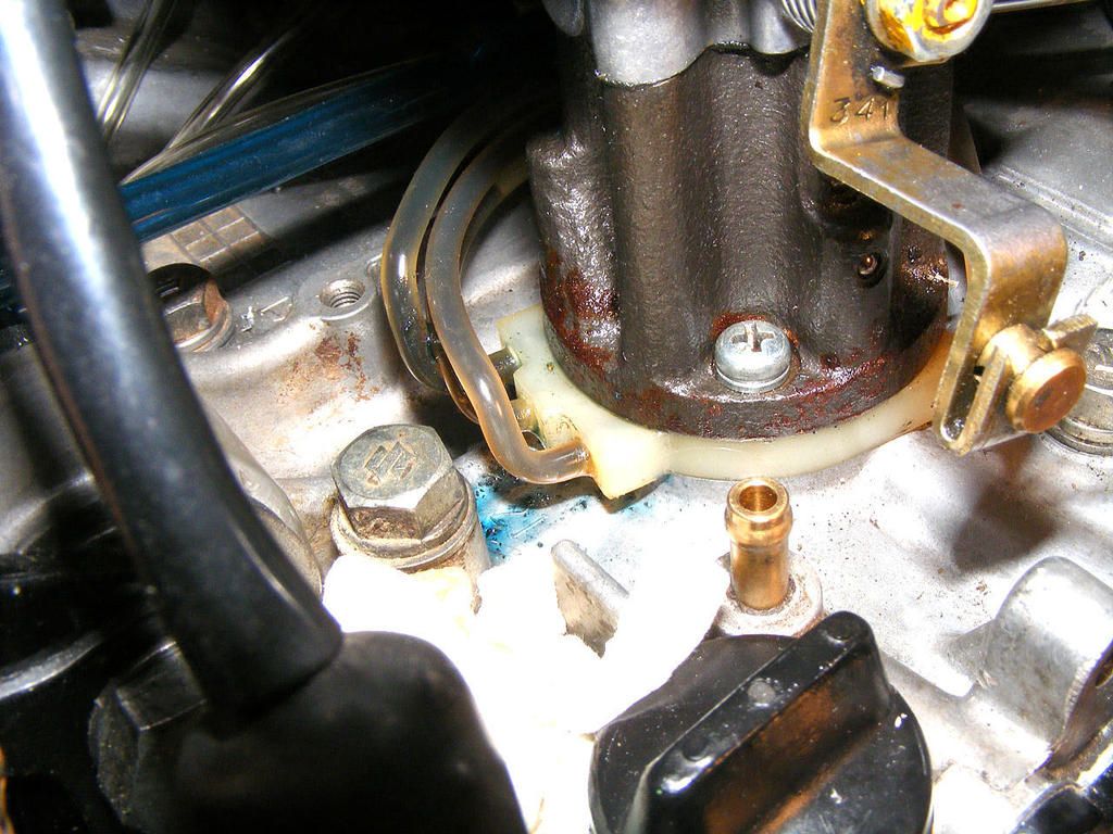

About 10 days ago I put some oil in the injector tank. Not much - 6oz by weight. Then I bled the pump. Cleaning up around the shop and I spotted a puddle of blue oil on the floor. CRAP!!. I mopped it up and walked away from it. I can't stand it. What else can possibly go wrong? I can't tell where it's leaking for sure, but it appears to be a line. That also means I have a bad check valve I think. How else would oil get in the line? I haven't so much as turned it over since putting oil in the tank. I flushed an flushed and primed these lines a dozen times or more on the bench. Never the slightest hint of any leaks. The lines are primed with CCI which is green, I went with the blue so I could make sure the pump was working. I seriously doubt the oils is coming from under the pump. The 6 o-rings are new and the pump is tight. Everything was surgically clean at assembly. Seriously, I give up. Make me an offer.
Re: I Give UP!!!
Then again. looking at the photo, just to the right of the lines, I see blue on the pump riser. The oil in the lines is still green.

Must be leaking from the oil feed banjo bolt and its two plastic washers. Try a pair of stat o seals. I hear that Bloop has a few spares. :-)

Best I can tell, it's not leaking at the banjo fitting. Much as I hate to, I'm gonna have to pull off the air filter and the carbs. I wonder if the octopus has a crack in it under one of the lines?

Post by markush »
Hi!
There are still those places for leaks:
# The seal between oilpump-head and -body
# The sealing ring of the shaft of the metering lever. This is quite common.
AFAIK there is no genuine spare part. You can fix this with a suitable O-Ring.
But it will not withstand as long as the original part.
# The connections of the oil tube from tank to pump. The oil runs very thin and very slowly down outside along the tube and then onto the pump.
Markus
Posts: 6212
Re: I Give UP!!!
Mark is correct. Leak from the top gasket is less common but the oil seal on the main shaft is a common problem.

See if the plastic fitting on the bottom of the oil tank is cracked......looks like it might be dripping off the pump feed line.
