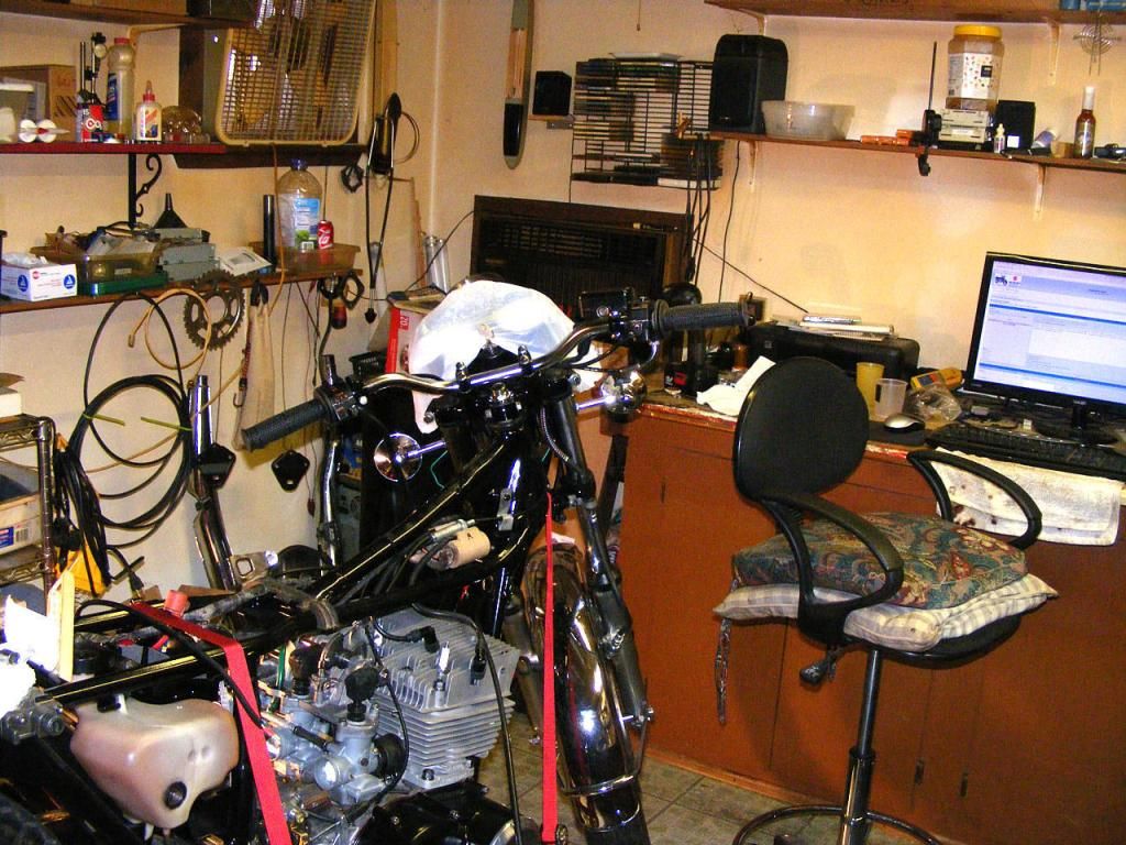

Well then, I guess I am SOL. The heated workshop is only 12x14 and has no ventilation I have 2 windows and a door, but it's cold out. There is an exhaust fan in one of the windoes for when the weather is nice. Heat and air is provided by a wall mounted window unit. I wonder if I would be OK if I opened a window and used the exhaust fan 3 or 4 times a day for a few minutes. The problem is I spend 95% of my waking hours in here. Wouldn't you? To my right is a full length of the room workbench.

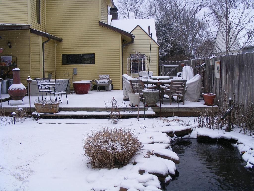

This is why I don't want to do it outside. This is such a goofy location. It's been snowing real light since yesterday morning - with a few breaks, Supposed to have a high of 65 Wednesday and a high of 31 Thursday. Currently 24.. Weather changes suddenly and rapidly here. Hence the tornadoes Koi pond in foreground The fish winter over just fine. Odd, they don't eat at all in the winter.
