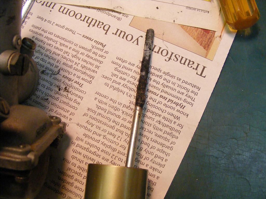

Started working on my spare carb set with the melted boots. Man that muk is the worst thing known to man. Completely liquid from the rack on up.
I have been wanting to try a propane torch on the muck to see what it would do.Well guy's -- it works! Turns hard and dry and sluffs right off.

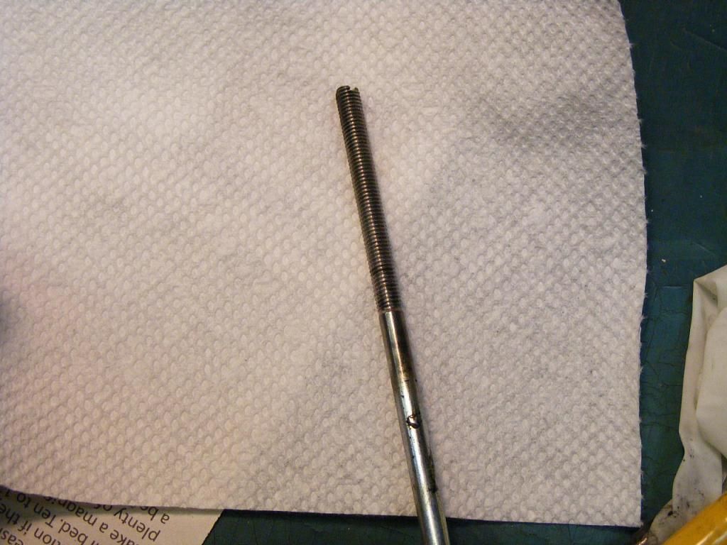

I tried first on the slide lifer threads. The first pic the muck is already charred. The second pic is after running it across the wire wheel. A 6" wheel on the bench grinder.

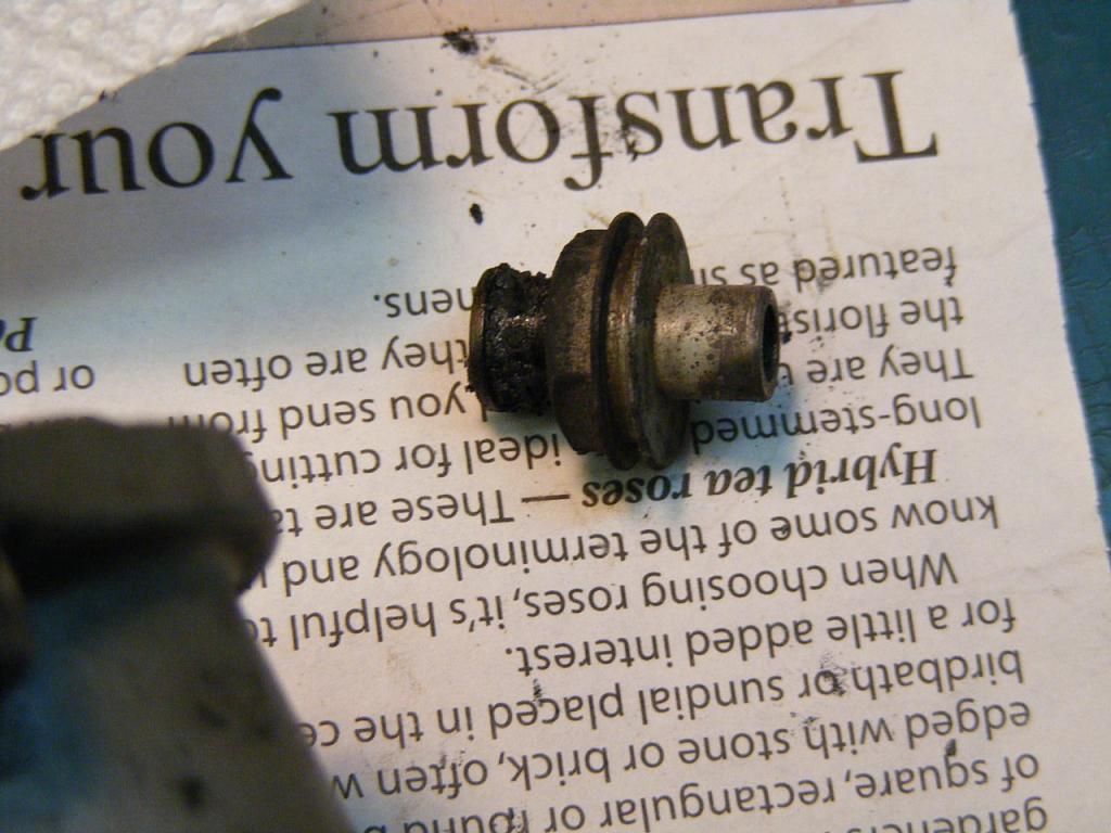

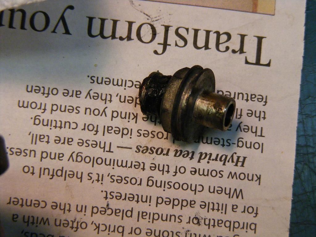

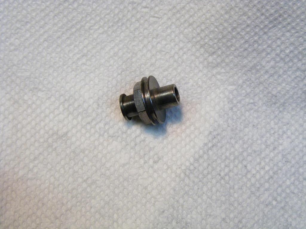

Then I tried it on an adjuster nut. There are 3 pics. Before char, after char and after wire wheel.'
