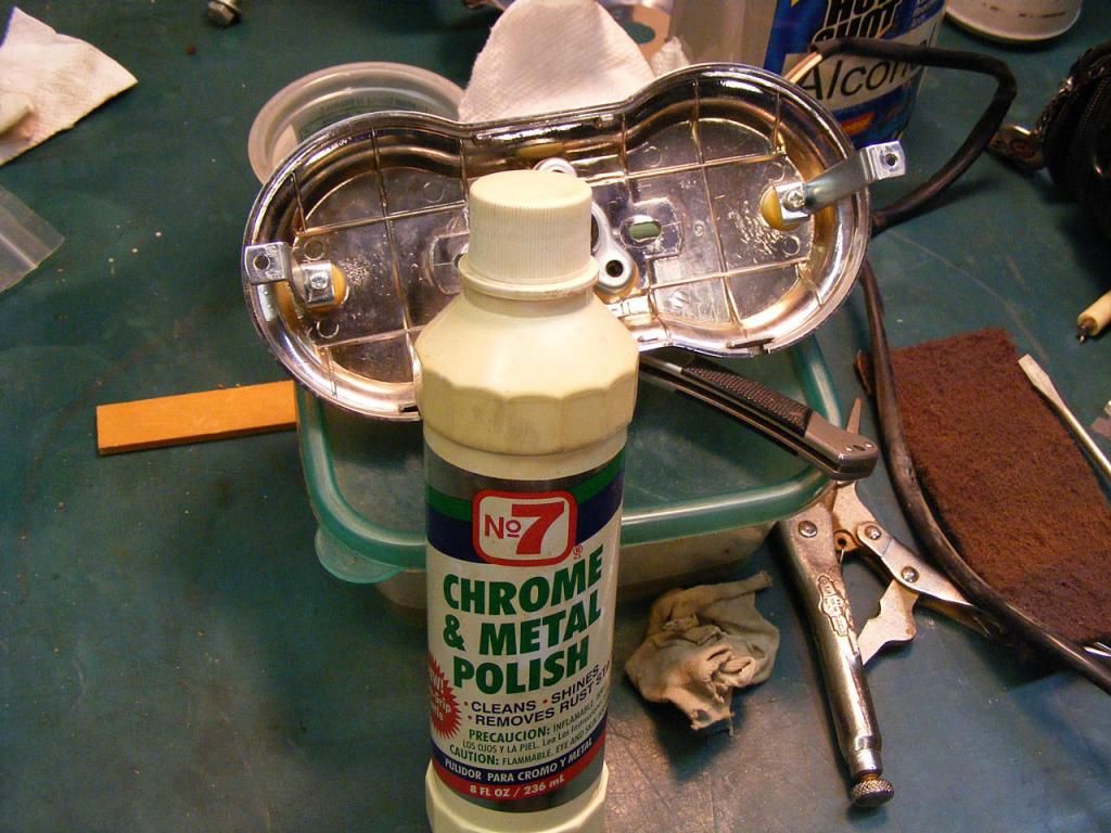

Re: Chrome Plastic
Today I took my rear light apart The backing plate (what the lens hooks to) was in terrible condition. Lots of surface rust especially on the bottom and back. The part is plastic and I hesitated to get out the chrome polish. I did it anyway. Much elbow grease later and the plate came out looking brand new. So, you can use chrome polish on plastic chrome! Not a scratch one!

Re: Chrome Plastic
Now I wish I had taken a 'before' photo. Maybe this isn't plastic? It looks, feels and sounds like plastic when I tap it with a fingernail. The inside looks like unpolished chrome. Want an inside photo? I seriously doubt that it's am alloy. It's just too light, but I'm not lying. There was a lot of surface rust on it. The inside says Suzuki 35710-11. I see a few bumps like chrome does on the underside.

Re: Chrome Plastic
here's the inside. The yellowish hue is from an incandescent light above it. sure looks like solid plastic to me BUT. All across the bottom and a few places on the back had rust?!
