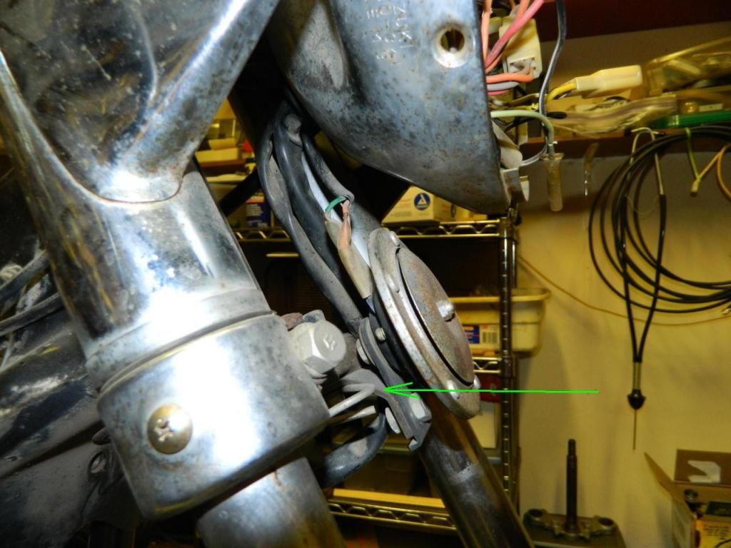

There is a hoop on the right side retained by one of the horn mount screws. I don't remember what passes through here. Apparently I removed it before I started taking pictures. What goes here?

Hi,not having a GT550 to look at....I'd say the tacho/speedo cable !....I have the 750,my guide is mounted on the left & my speedo cable goes through it

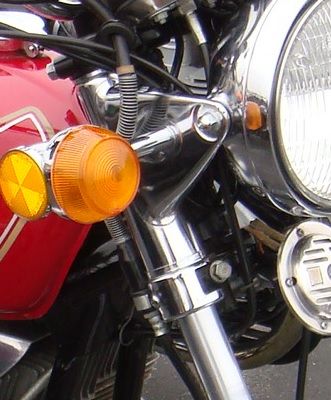

It should be mounted on the left side and the speedo cable runs through it (or at least thats what I have seen on other GTs)
On the GT550, the tacho cable runs through a wire loop which is centrally mounted on the frame, you'll see the threaded hole on the forward-facing frame gusset under the steering head.
Re: Simple 550 question
Mike, you can actually see the mounting hole for that loop in the pic I posted. Judging by the coloration around the hole, something was mounted there. But I only find the one hoop in my parts bin. I guess I'll have to keep looking. I was hoping it was with my tach cable, but it's not.
I found the part in the cable fiche. It is called "clip, tachometer cable" so I guess you are right. The loop is NLA so I best find the one I had.

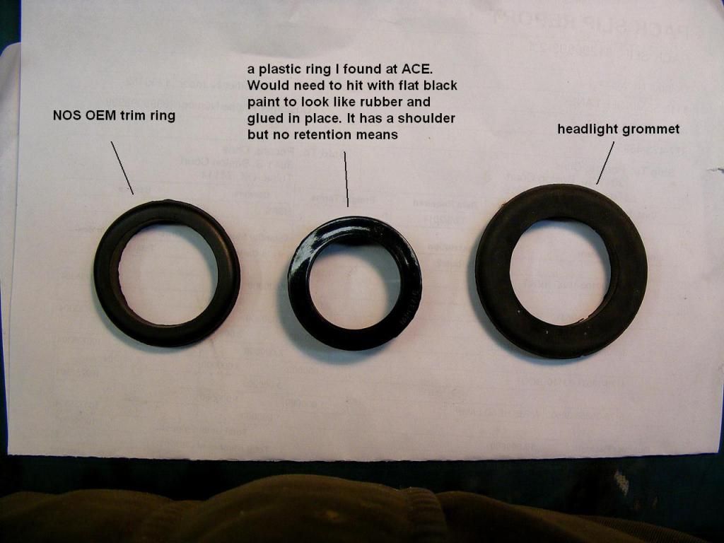

There was one positive event while searching through parts for the missing hoop. I happened across a brand new obsolete spark plug trim ring. Never used, soft and pliable. It's the last ring of the 3 different ones offered by Suzuki. Part number 33545-34000. Now I just need 2 more
I am going to use headlight grommets for trim rings (as suggested by pearljam), but they are so large that they really don't look right at all. But, it beats nothing at all.
I googled for the part by number. No one has it and no one is reproducing it.

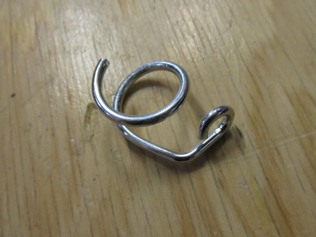

Is this what you are looking for:
http://s1290.photobucket.com/user/fsaut ... 1.jpg.html" onclick="window.open(this.href);return false;" onclick="window.open(this.href);return false;" onclick="window.open(this.href);return false;" target="_blank"><img src="http://i1290.photobucket.com/albums/b53 ... 759aa1.jpg" border="0" alt="Clip photo IMG_1972_zps95759aa1.jpg
