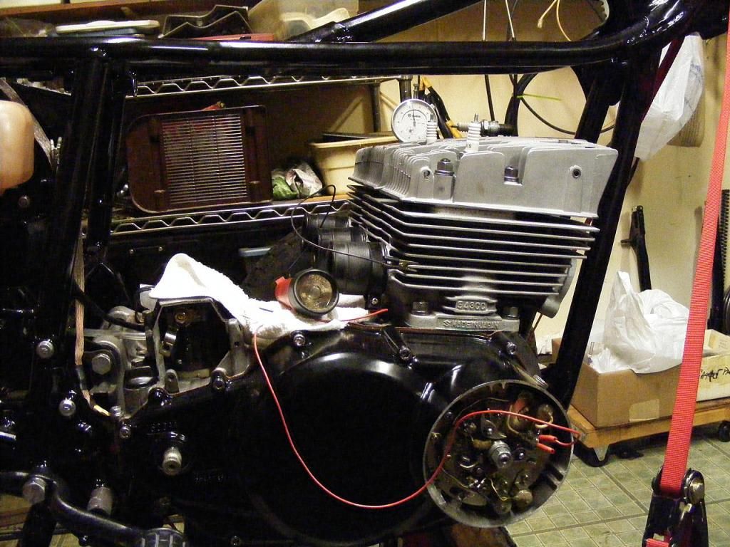

I have checked the timing marks on the propeller with a dial indicator. They are spot on the money. So I'm timing the left, appropriately gaped at .014 and using a static timing light. The light goes out a degree or 2 short of the mark. I have rotated the plate as far as possible as far as it will go clockwise. Gets close but I run out of room on the plate slots. I need to tweek it just slightly more but there's no rotation room left. I am certain these points are stock and the bike only had about 3500 miles on it.

I give up for tonight. Something is really goofy here. Now when the light goes out, the propeller is not even in the window. Yet with my indicator stopping .132 BTDC it is spot on the 'L' mark. And yes the indicator is in the left bore. So I know nothing is loose as .132 BTDC is always spot on the 'L' mark. Not that it makes a terrible amount of difference, I am turning everything in a clockwise direction.

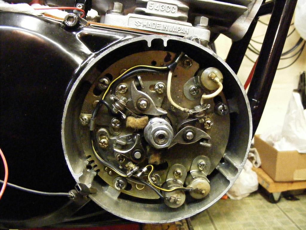

Can someone verify that the timing plate is in the correct index? I can't find any pictures of the Kokusan setup. Only illustrations. On the illustrations I find, the single condenser is in the 9 o'clock position. However, the dual condensers are right where they are here (4:30 - 5:30). I haven't messed it yet this morning as I need to verify the plate position first.
Here the left points are at the 3 o'clock position. Seems like I remember them being at the top, but it's been a long time.

I was searching for a picture on line and then remembered that I had a bunch of pictures here somewhere of one.
That looks exactly like the 72 that passed through my hands last year. I have a picture here and it seems to be identical. Interesting that on "mine" the points plate was rotated almost as far as yours. It appears to be hard against the screw in the lower left slot.
I would try to lengthen that slot another 3mm and see if that gives you enough room to set the timing.
Hope that helps
Hope that helps
Re: Timing -- Lost
I got the left in. Gap is in tolerance and I didn't completely use up the slots. Working on the right now. Thanks for the photo.
