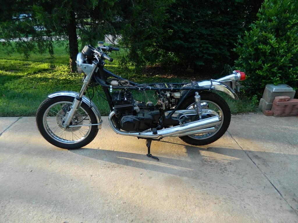

I think Mike is talking about the center stand ---- already on the bike. If you have a center stand, thet's enough to change the wheel. Center stands are on the bikes from the factory. Most people don't take them off unless mounting chambers require it. You can't even adjust the chain without a center stand. Like this!. Note rear weel is off the ground.

gary your overthinking the idea. just get a floor jack and a chunk of wood on a level surface, jack the sucker up. all good.
