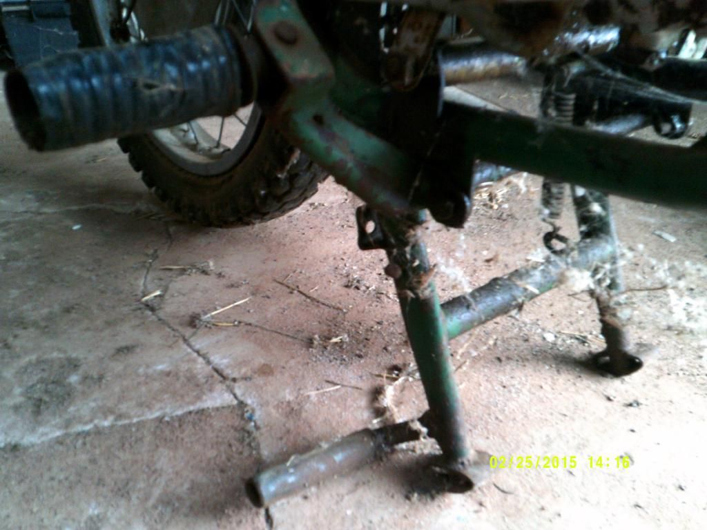

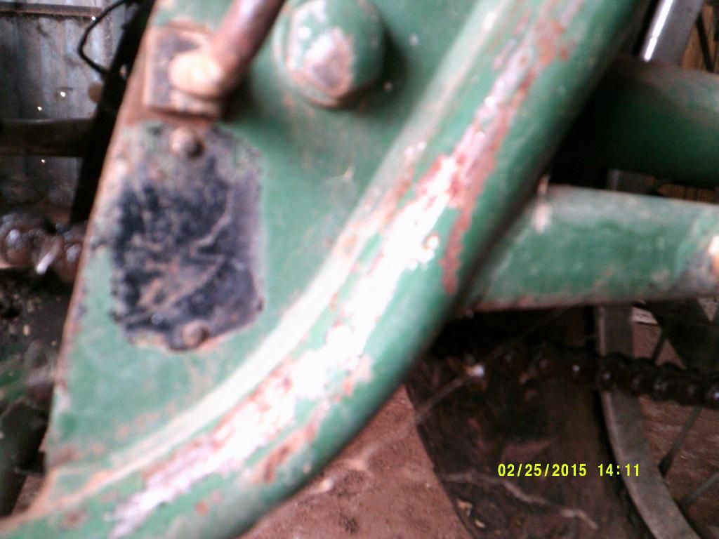

The only place on the frame is evidance of a tag (no longer there)pinned on the gusset just above the left foot peg,in the only photo out of 10 that i managed to post you can see the original black paint where the tag was,i have a rv-90 with the same tag-same location stating the model of frame ie:1973 rv-90,In australia we know these as private imports as we usually have a bigger aluminium tag with australian design rules stamped on with frame number and year of production-these are always pinned on the head stem.as i stated in my first post i am 53 and struggling with posting pics from photo-bucket to here,very frustrating.there seems to be no guidence on this forum or photo-bucket...Ken

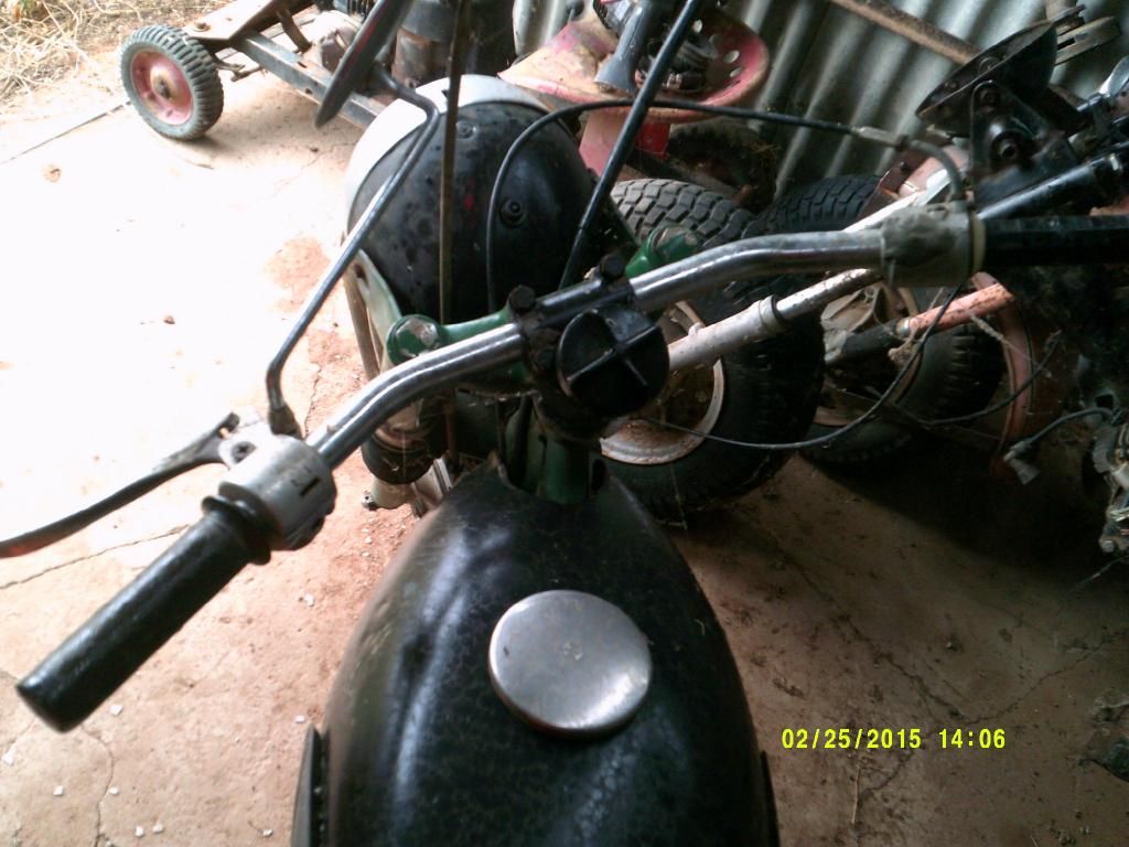

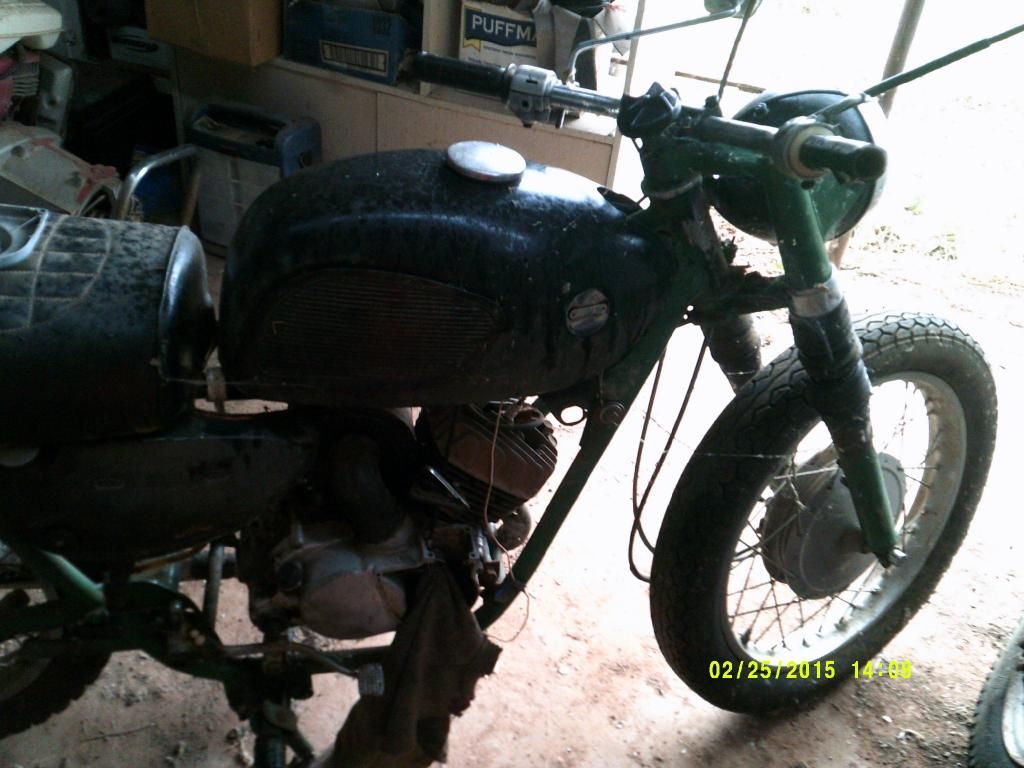

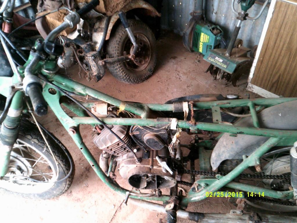

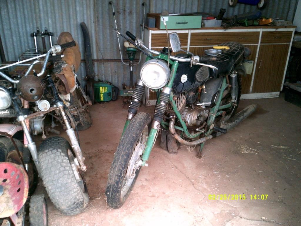

Well,its amazing after a ride on the gsx to clear the mind i think i have done it,try some more

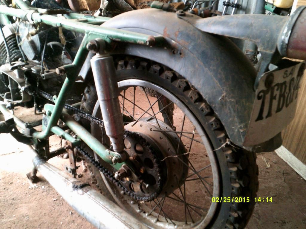

Pretty sure it's a tc250. Footpegs and enclosed rear shocks give it away. The only numbers were on the plate that was riveted on by the left footpeg

Is it just a trick of the light, or is there a number stamped in the frame gusset by top of the right side shock ?

Thanks guys,what i will do is strip it down completely,get the frame media blasted and look for the number before painting.now i know how to post pics i will do a progressive report on the build.can this thread be transferred to the resto section or do i start again?
I already have the correct engine on stand-buy just wanted to make sure about the frame.thanks...Ken

So no number stamped by the shock then ? I just find it odd, as I have yet to come across a Suzuki that doesn't have something stamped into the frame somewhere, in addition to the usual tag, label or plate which often gets lost with time. The only exceptions I've heard of previously have been frames that were replaced and not re-stamped. The three locations I've seen are headstock, near the right side foot rest and near the upper right side shock mount. Sometimes they are hard to spot if the frame has been powder coated or repainted - or damaged I suppose, but it seems strange there wouldn't be one at all.
