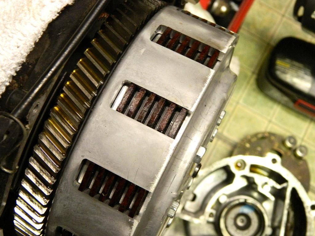

I pulled the clutch cover off as a matter of course. I swear the mileage of 3,240 on this thing is correct. There is not even the slightest hint of notching on the basket. Looks brand new. After 'ooohing' and 'aaahing' over that, take a look at the pressure plate bolts. There is definite variation in height of the bolt heads.

On most Japanese bikes the clutch bolts are bottomed out and are not very tight - maybe a couple of foot pounds. Because they are bottomed out they should all be the same height. It's worth popping them all off to be sure that everything is OK in there and no broken posts. With so few miles it's highly unlikely that there's anything wrong, but it warrants a quick peek under the cover.
