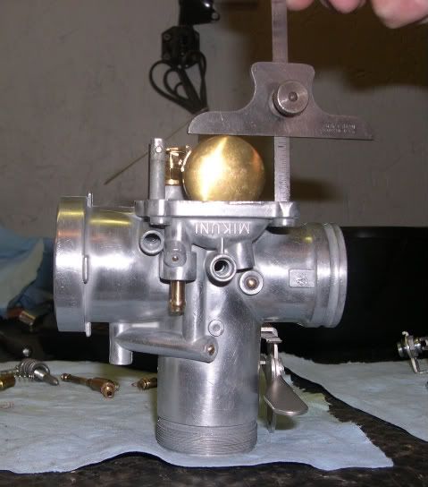

I had a very similiar problem with my 76 gt750. If I would put a hand over the intake for the left cylinder it would fire for a few seconds. I pulled the carb apart a couple times with no success. The last time I noticed that the bowl had too much fuel and so I checked the fuel valve (on the float) and it had a piece of crud blocking it open. Fixed the problem, now the exhaust heats up about the same and runs on all 3!
Seems weird to me that having too much fuel in the bowl would prevent that cylinder from firing but "proof of the pudding in in the eating"

Your '75 doesn't have any crank chamber drain plugs, so how are you finding gas in the crankcase. Or do you mean there's gas in the cylinders?x6 Scrambler wrote:The plugs appear to me to be dry. After leaving the petcock open for a couple of minutes I get gas in the crankcase, but no gas comes out of the float bowl overflow. Go figure.
Joe

Agree with CJF. But if enough gas runs into the crankcase that you can drain it from the bottom plugs, I can't imagine that it wouldn't be also running out from the bowl drain hoses along with soaking wet spark plugs. What float level did you set, and how did you set it?x6 Scrambler wrote:My crankcase has a drain plug on each side just in front of the engine mount. My engine serial number is 77743.
JOE

The disassembled carbs soaked all night in carb cleaner. New main and pilot jets arrived from Suzuki today. I used the float valve and starter plunger from a Keyster kit but not the jets or needle. I washed the carb body in my parts washer and polished it up a little. I'm just now reassembling them, I attached a pic of how I measure the float height. I set the float at 27.3mm or 1 5/64". The end of the measuring tool rests on the gasket surface. I tend to agree with Craig that the problem is in the choke circuit or the pilot jet.
Thanks Everyone
Joe
