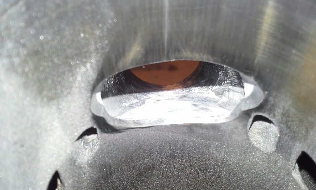

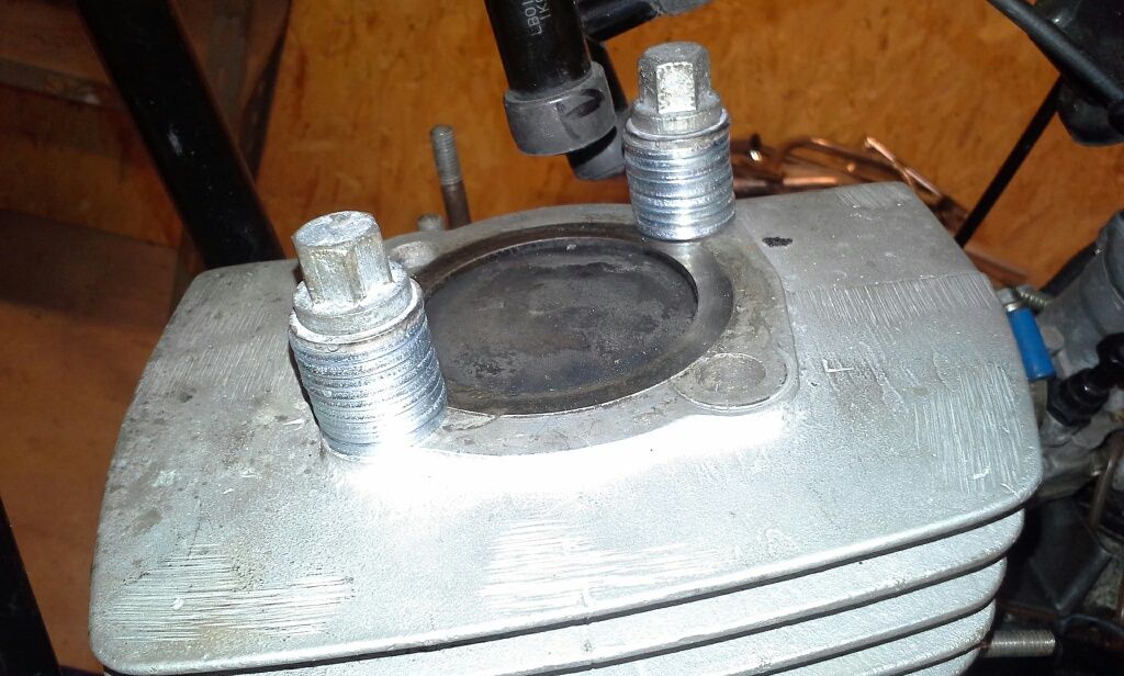

Hi Guys, hereby some updates from the garage.
It's been a while since i last posted, been really busy in the shed.
Most of the ordered porting tools have arrived and i am learning by doing (MAYBE
First the exhaust, half way done. IT IS EQUAL TO BOTH SIDES-BAD CAMERA ANGLE
Needs to polished up a bid and then some chamfering:

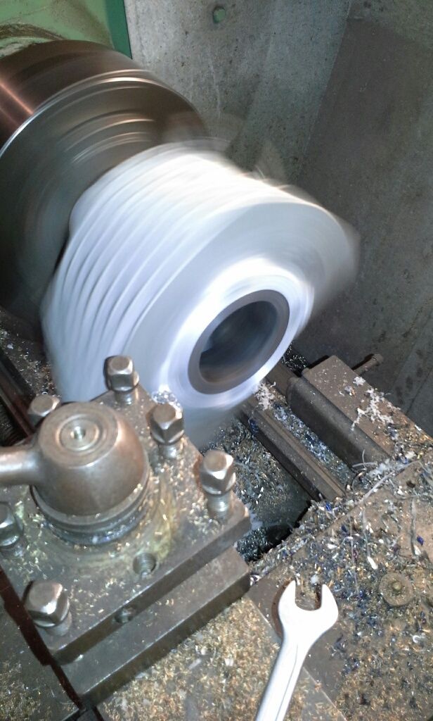

Still needing the angle die grinder to reach the transfers, but it will arrive later this week, not for the roof of the transfers but for the bottom after fitting base plates.
Spacers are also made, and the top of the barrels are matched to be flush... On to the lathe..

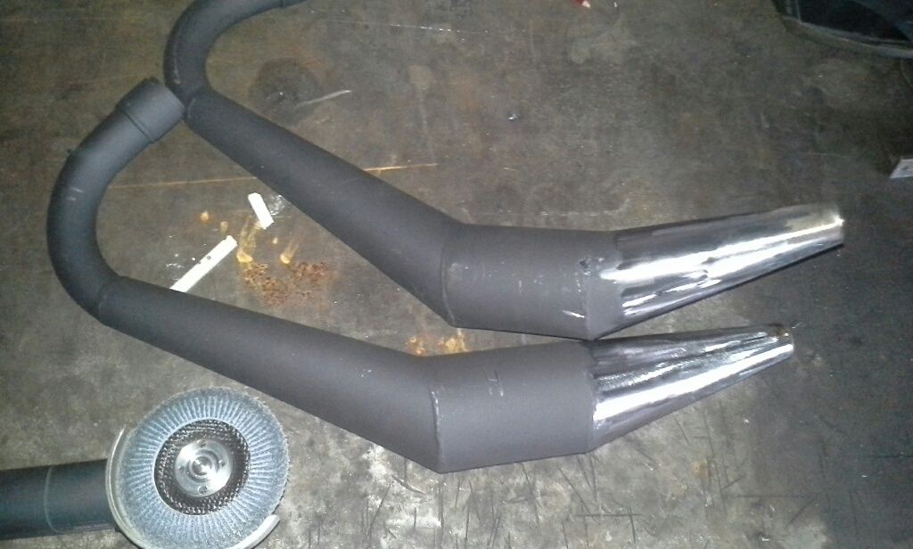

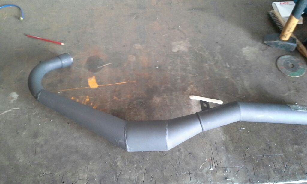

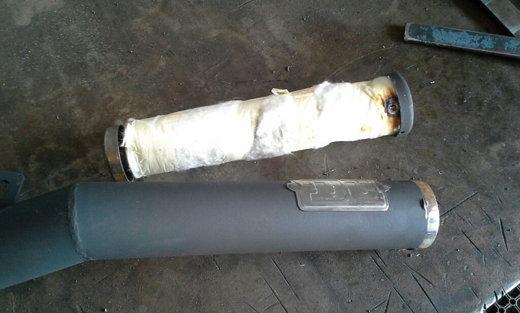

To add a Little extra Work i have read about modding the DG's with a real stinger and a real silencer / can..
So i decided to cut my new DG

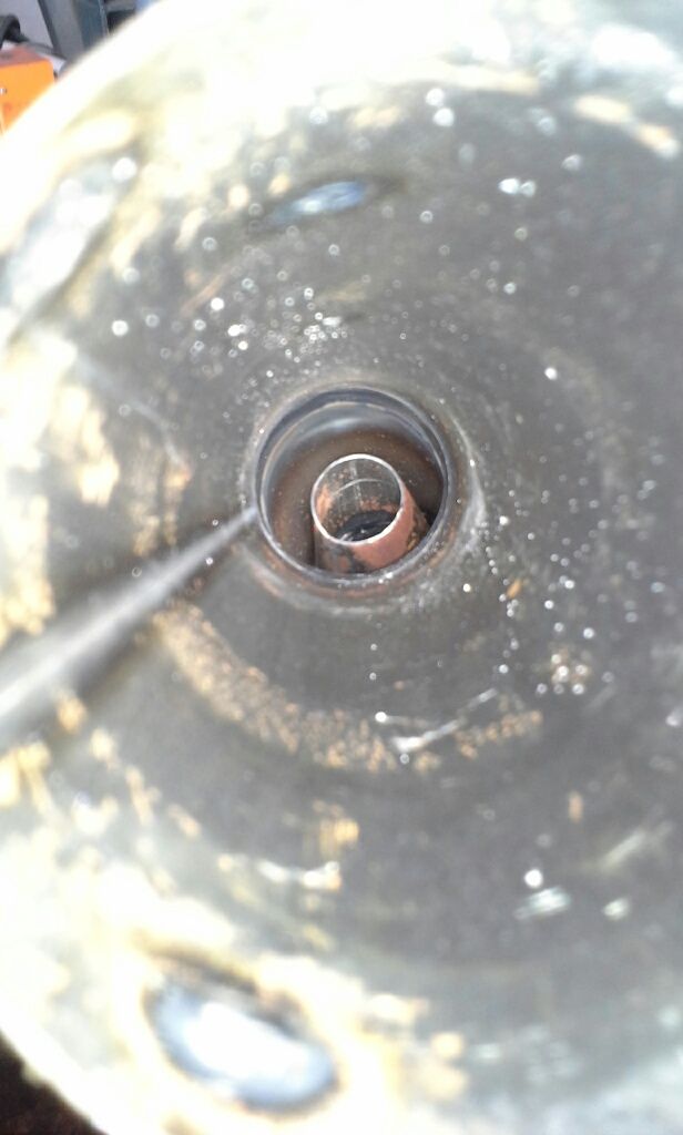

Sort of funny Construction. when baffel removed the end of the last cone can bee seen through the outer pipe, that connection to the perforated tube can't be optimal.
Here all stripped, they are extremely lightweight, now i only need to make new cones to accommodate the stinger OD on 22,4mm
More to come..

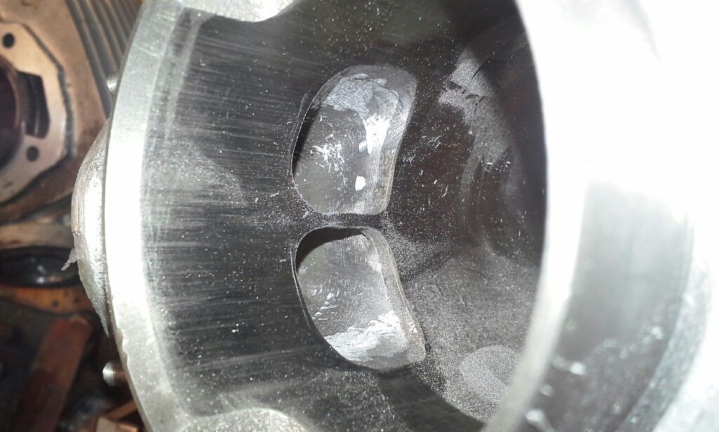

Almost forgot Pictures of the intake
Also some finishing off and chamfering still needs to be done..
