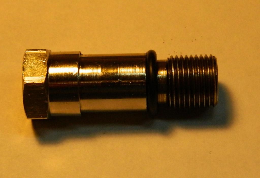

I have a harbor freight gauge that I own and one that I rented from pep boys. The harbor freight one reads 60 across all three(same as before) and the pep boys one reads 40-40-60(same as before). I am starting to believe that these gauges are not sitting right in the spark plug holes. I should also note that I tried adding some oil to one cylinder only to have a minor boost in pressure for one attempt then it was right back where it was. I was thinking dome Teflon tape might help if the threads aren't properly sealing it. As for technique I just let the electric starter have at it until the gauges stopped.

HF gauges are notorious for reading 60PSI . I'd go and borrow one form Pep boys again and try it on the lawn mower or a different bike or the family car - if you can get to the plugs and see what it reads. I suspect it will read very low.
