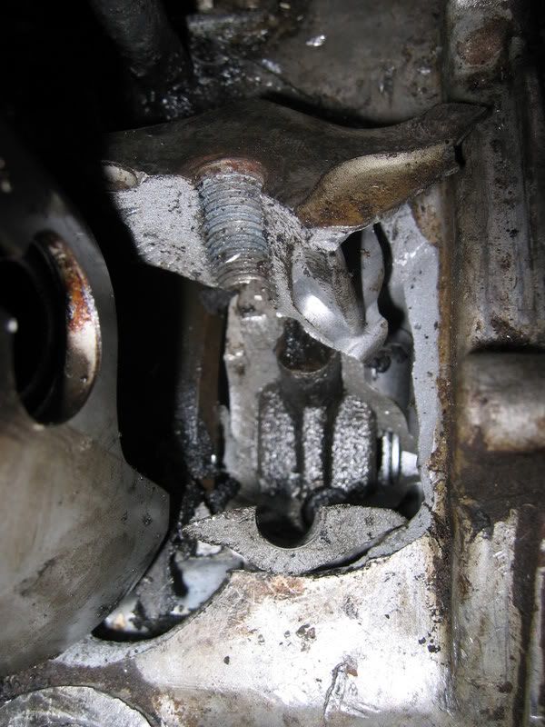

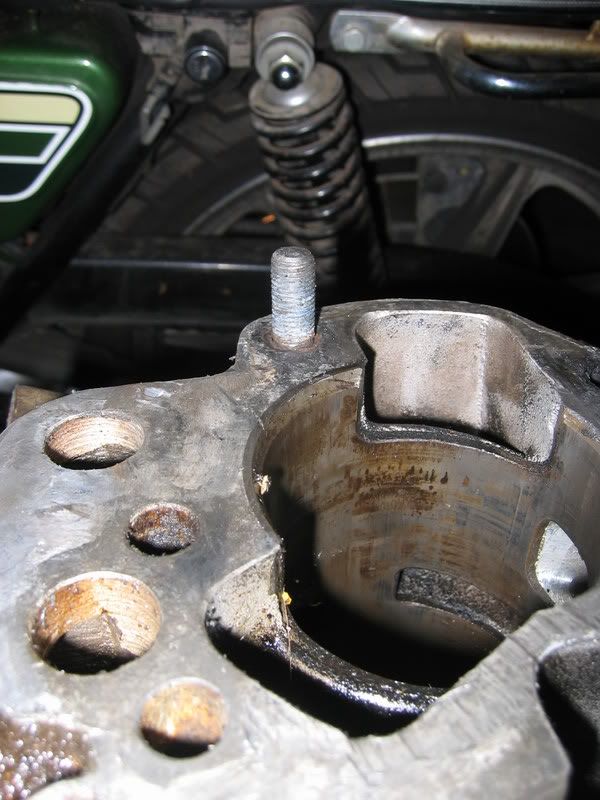

Here's a picture of one that I pulled over a couple weeks and the stud ripped out of the top case.
Stud still in the loose cylinders:
Top case where the stud broke the casting:
I use a junk head to pull with, personally I wouldn't use a head I was going to run to pull with (heads for these things are pretty easy to find).
