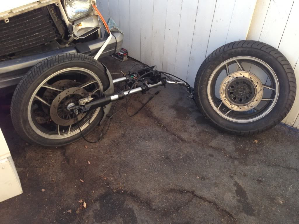

Re: GT550 budget build

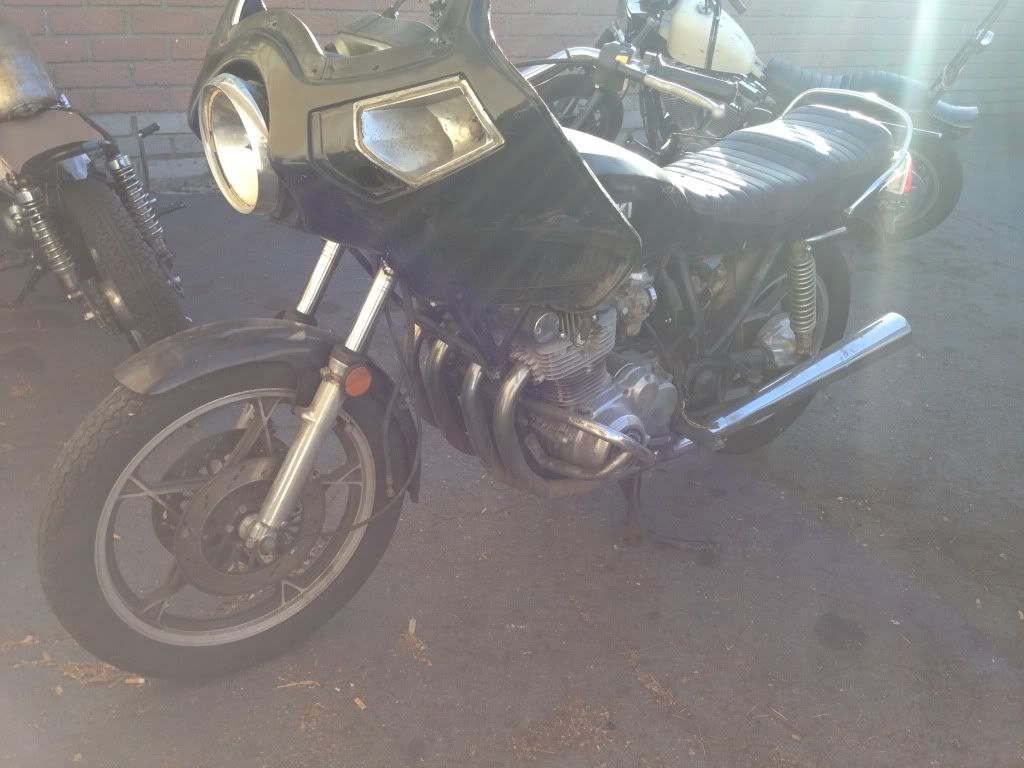

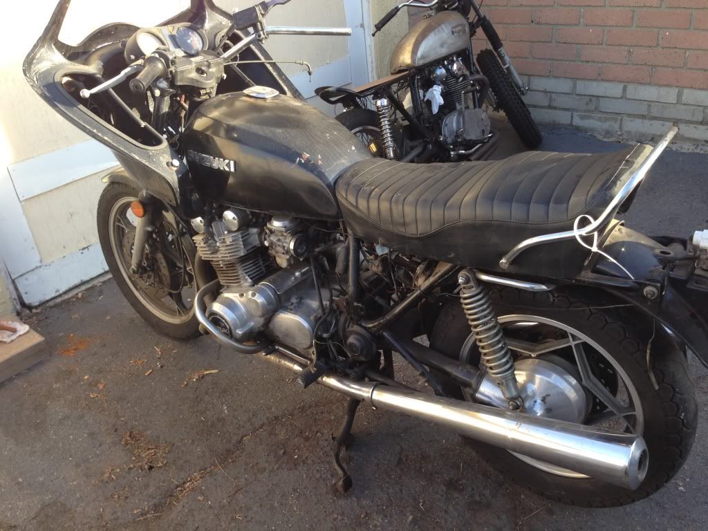

Well I found a steal of a deal on an 80 GS1000 parts bike, so went and picked that up yesterday. When I got there the seller had an extra set of wheels and front end he only wanted $40 for so I picked those up as well, the spare wheels and tires seem to be in nice usable condition. I will have to adapt the rear disk brake for the GT, but I like the idea of doing so regardless, it is a 17 rear, not the 18 I was hoping for, however there seems to be a surplus of GS parts in my area if one day I want to go with the 18.
Not fully sure what I'll do with the GS yet.. It was just such a good deal I couldn't pass it up. The PO used it to get his other 1100 running so he took the regulator/rectifier and a few other bits, bike was last registered in 2011 so there's probably a good bit of DMV fees, depending on how much I might try and fix it up or just sell it for more than I paid for it.

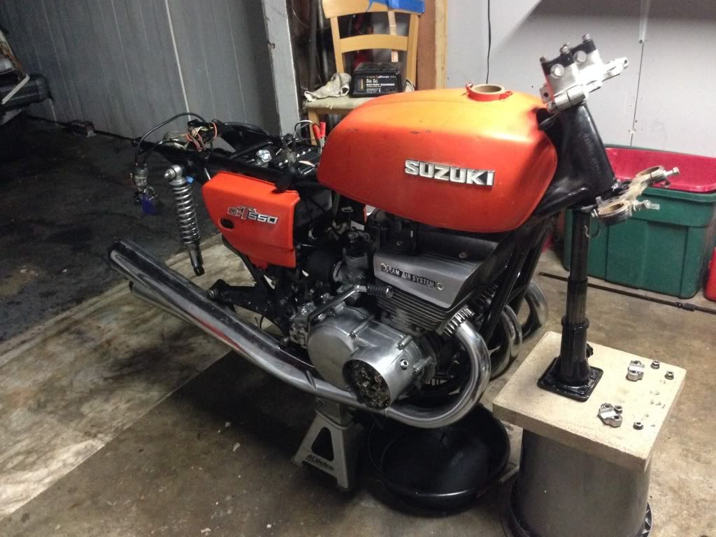

Starting to feel like I might be able to ride the GT come February
. If March rolls around and I still haven't done my first road test then I've been wasting time and not focusing enough,
if that happens I would encourage the members of this board would give me some serious crap..
The gas tank has been a pain to clean and seems to have gotten to a point where the electrolysis is no longer working. Think I might give in and buy the Kreem cleaning kit. The petcock on the other hand cleaned up really nicely, just need to wait for those new fuel screens and gasket.
Although I still have quite a bit of work remaining, I am feeling like some good progress will come by week's end.

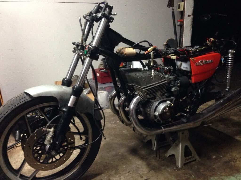

I give ya 10 points for creative use of garage extra's for the front end stand

THIS LINK gives details of GS wheels.
It seems the different models, not years have different wheels.
Might give some different options. Lots of other models shown if you tweak the link.
But if you're not a link tweaker, try THIS ONE and save it as favourite or to your desktop.
Yes I have visited his site quite a few times now. Really cool how much information he has compiled about Suzuki bikes.
I believe the spare wheels and front end I got are from the 1100 model. I think they will look good on the 550

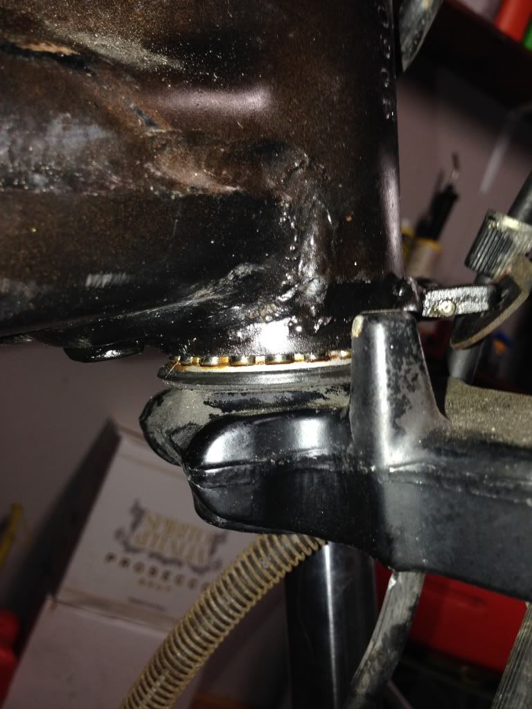

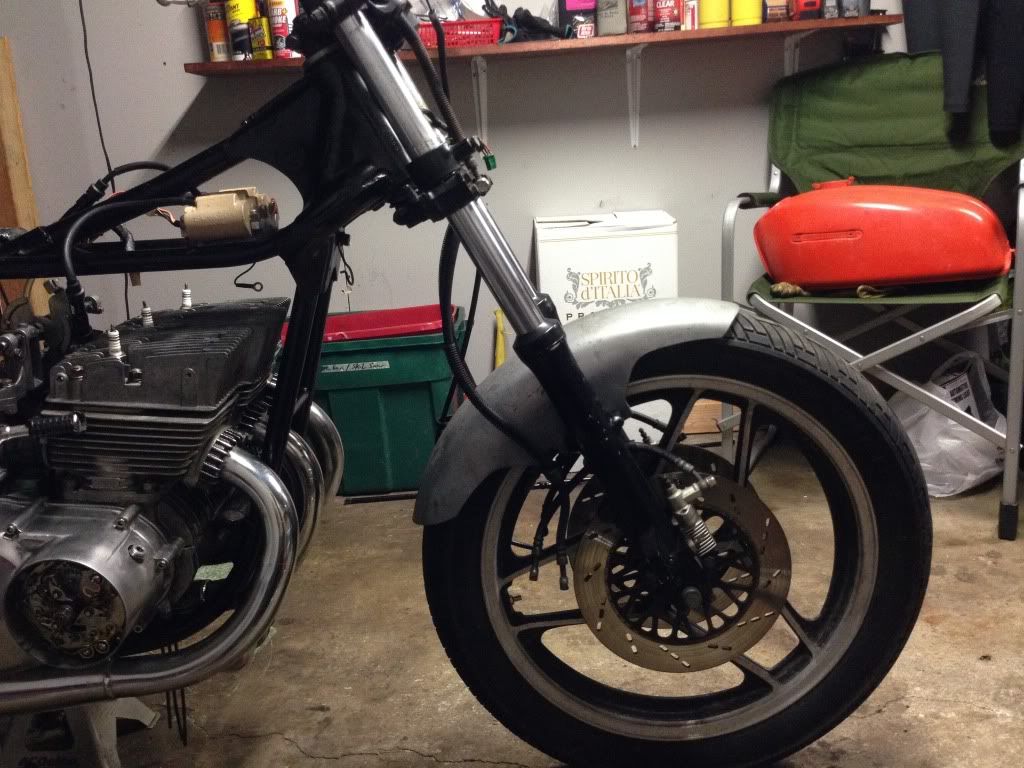

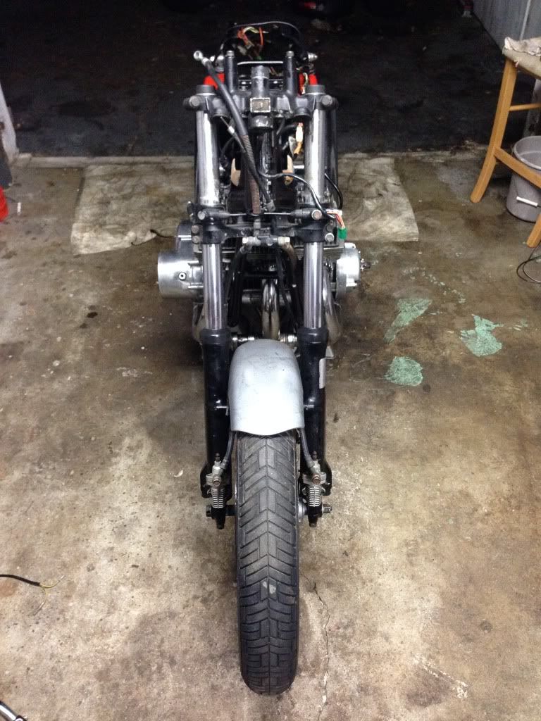

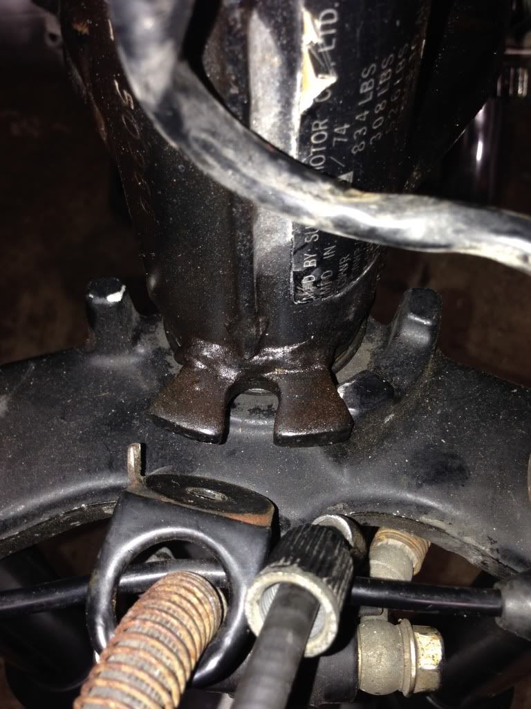

More pictures.

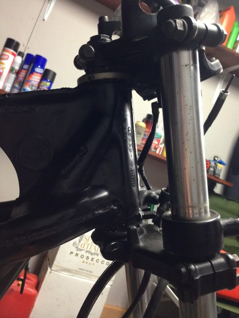

This is just a mock up of the gs1100 front end fitted to the 550. Looks like it might work out nicely, couple of things I need to consider however:
1. I haven't torqued the steering stem down to spec, so I can't tell if the lower tapered bearings from the GS stem will be a precise fit in the GT's neck since there is about 2mm of space as seen in the picture, but I am inclined to think once fully pressed together it would work. HOWEVER, this is my first attempt at messing with a steering stem so please correct me if I am making false assumptions.
2. I'm not sure what exactly they're called, so I'll call them "stays". But the steering "stays" for the GS prevent the front from turning right
so they will need to be modified so I have full range of steering.

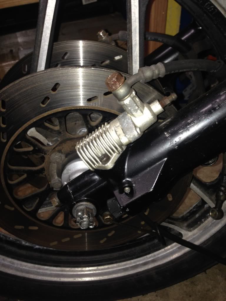

3. I know I should be asking the GS forum this question, but anybody know what the purpose of the silver parts at the bottom of the GS forks? It looks like brake fluid goes into the forks?..
- Posts: 3250
The lugs that restrict steering are lock stops and might need modifying to be more like the 550 triple tree stops to get the full range of steering and also to be able to use the steering lock.
The silver parts are the anti dive system. When you use the front brake it stiffens the suspension so the front end dips less. Some can be blanked off, not sure about that particular one.
Looks like the rollers aren't right. Maybe the cup in the steering head base needs to go further up. You shouldn't see the rollers when it's nipped up. Did you mix gs & gt parts? Make sure the top cup of the bearing fits correctly.
