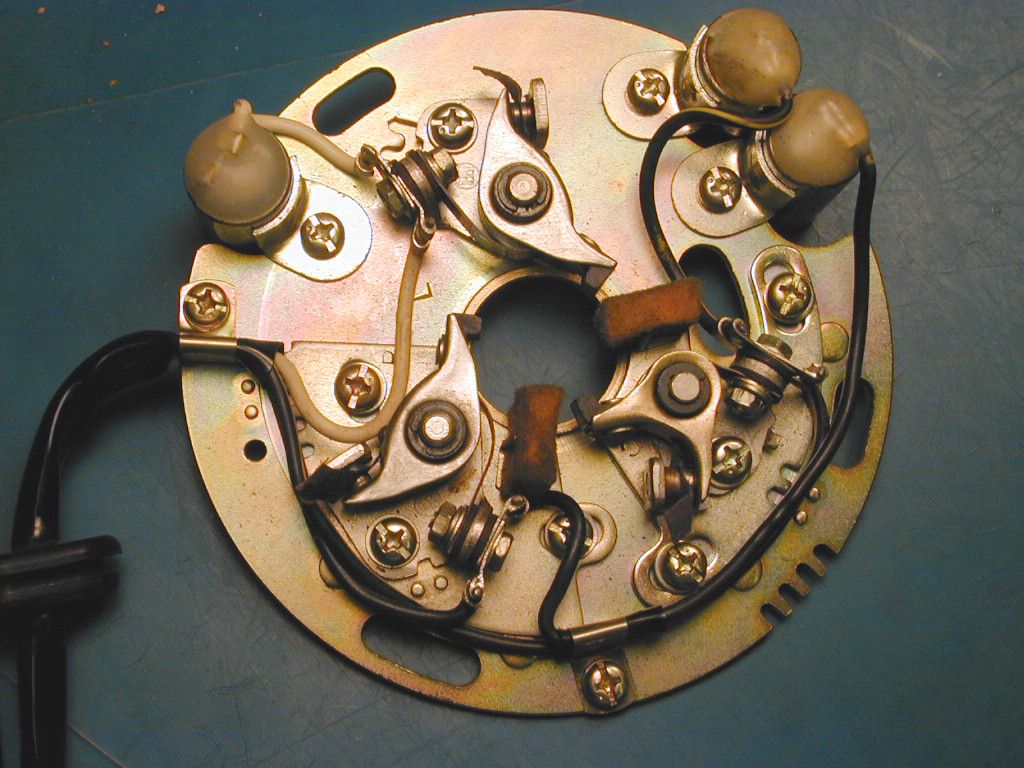

There is no room for any type of socket. It must be a spanner, and a thin one at that. See? This is a NOS assembly. That's why none of the screws are mangled. I picked this up a few years ago for $26.00 on ebay. Complete as you see it. Now resides in RedZone.

M3 (M3 without further informations means: "Normal" thread, Ø 3 mm, thread gradient 0,5 mm)While we are on this subject, does anyone know the size of the tiny nut that retains the assembly sandwich? I have found nothing that fits it, It does not appear to be metric or SAE. Even tried my distributor wrenches and tiny spanners. So, I have been using a teeny pair of channel locks. I'd rater not do that, but I can't find anything that fits.
Just checked. It measures 0.214. That would make it a 5.5mm. No gots 5.5 wrench
