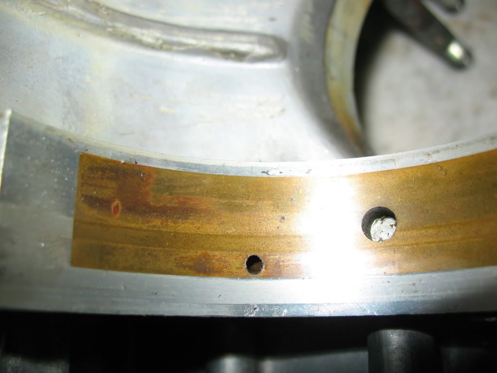

Heres a photo of what the top case half on the left side looks like.

If the leak is from the top then that issue is not because of the pin. A longer than stock pin or a pin that isn't fully seated will lift the whole bearing (and sleeve) and push it hard against the bearing saddle in the upper case half.
There are a few conditions that would result in a leak at teh top.
Bearing OD smaller than the saddle diameter
Bearing OD larger than the saddle so that it cannot seat correctly
Raised metal holding the bearing off the surface
Gouges in the saddle allowing oil to pass out.
There's probably more that don't come to mind, like the crankcase expanding away from the steel bearing when teh motor gets hot.
The motor needs to be stripped and inspected. I like Stu's idea of using fingers to feel for rough spots. Fingers can detect surface imperfections of less than 1 thousandth of an inch.
I'd start by cleaning the case halves and inspecting the joining surfaces. I'd countersink all the stud/bolt holes and use a clean new fine file to cross file the mating surfaces gently to identify and remove any high spots.
You can use bearing blue to see how well the case halves mate.
Then I'd smear some bearing blue on the main bearings and lightly assemble the cases with the crank in place. Strip it again and look at the blue to see where the bearings are contacting the saddles.
When you are happy with all the above, use new O rings around the bearing outer sleeves and reassemble with a smear of Hylomar on the case halves.
When you slip the new O rings onto those bearing outers, check that they are proud of the surface. It is quite possible that they were re-machined to take a thicker O ring and stock rings may be too thin to seal.
