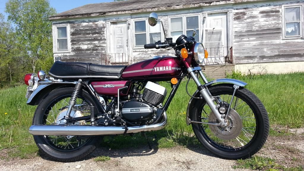

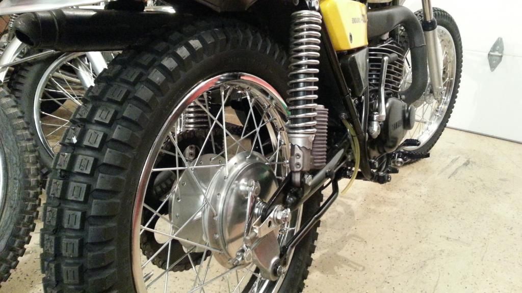

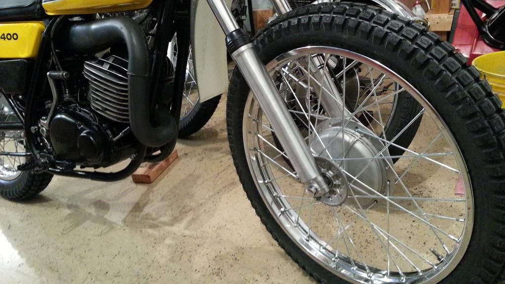

I've used the spokes from Thailand. They are ok but not perfect. They will work. I used Buchanan spokes on my 72 GT550. I sent one of each spoke and had them match to exact specs. Went with polished stainless. The total shipped was like $322, so not cheap for sure. My originals were to far gone to mess with.

I said it before and I'll say it again, I just love what you did with those rims! Very cool and a really sweet looking ride. It's easy to see a lot of time and a substantial amount of $ went in to her. It's true love
