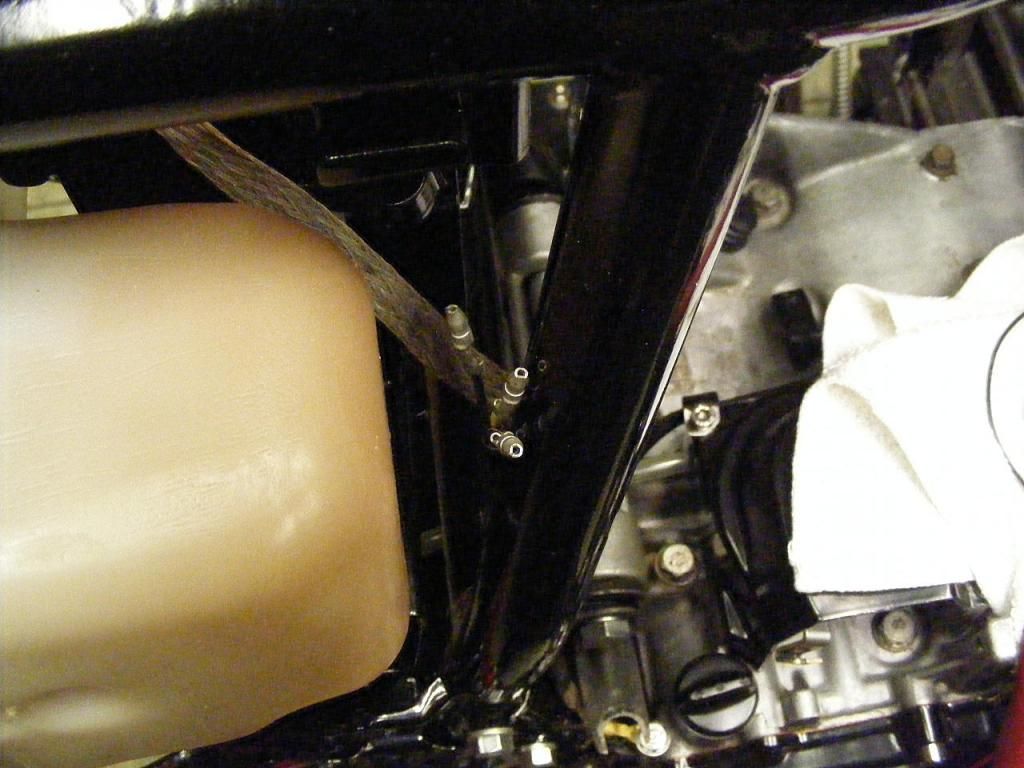

I FOUND IT! I FOUND IT! One of the 3 leads in the harness decided to lean itself against the ground strap. Yes, the right lead was grounded. DOH! Works much gooder now.

The usual short is that the points wire is contacting earth through the points even when open. I'd remove the points lead and condenser lead from the annoying cylinder and use a continuity meter on the moving point to show it does break when open. Then reattach each lead in turn and check its still behaving (you may need to disconnect the bullet to the coils, near the airbox).

Good find! just seen your latest post
You woulda found it by my suggested method which involved disconnecting that loom bullet, but I'd not have guessed why you'd have found it!
Re: Timing -- Lost
Gotta remember my bike is not together yet. These bullets are open because the harness isn't on yet. It was right here.
