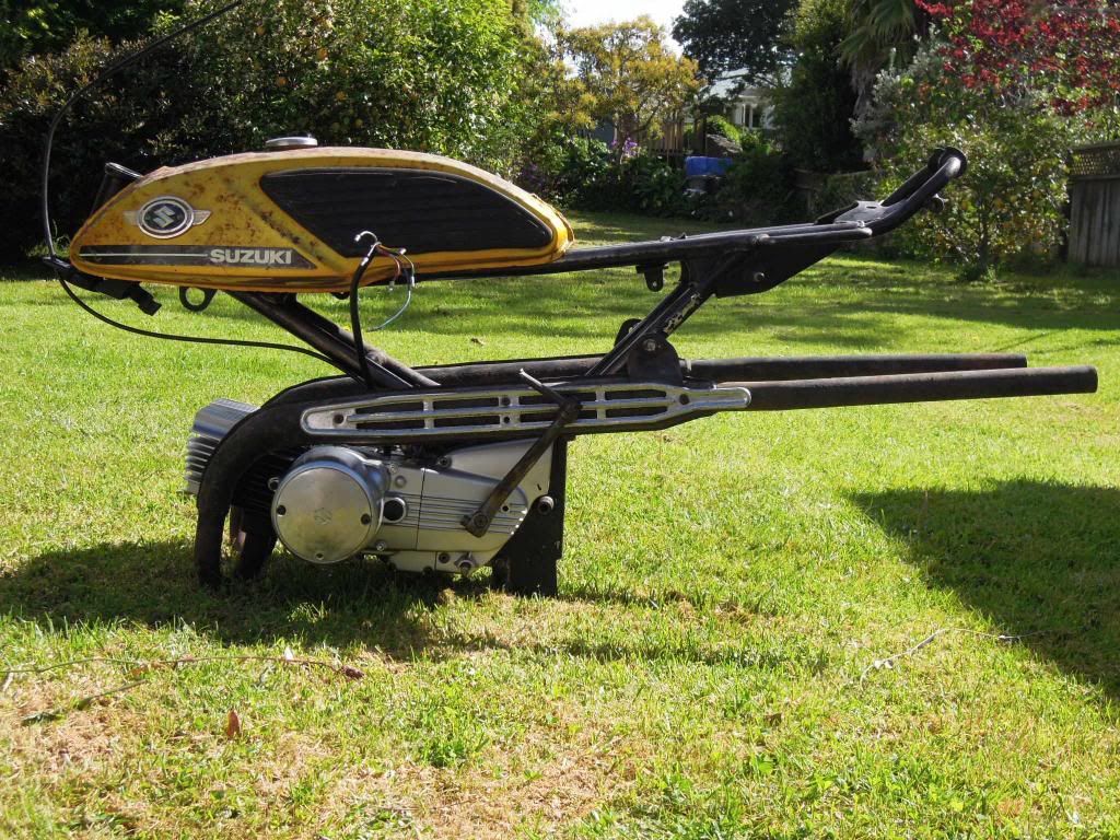

Indeed. I saw this pic (below) of t125 on Do the Ton that was just a frame tank engine and pipes, and it looked like it was going 100MPH! Looks like some sort of spaceship just sitting there.
And turns out the head studs (I broke one and have been drilling it out.) have the same thread pitch and size as all the clutch cover and other side as well. Went down to Home depot to see if I could find a match. It appears to be a 6mm 1.0 thread pitch. I was kinda shocked they had the tap and bit set for it too. So I guess I have what I need to try to retap it. If it doesn't work the next move is a helicoil. Fingers crossed.
