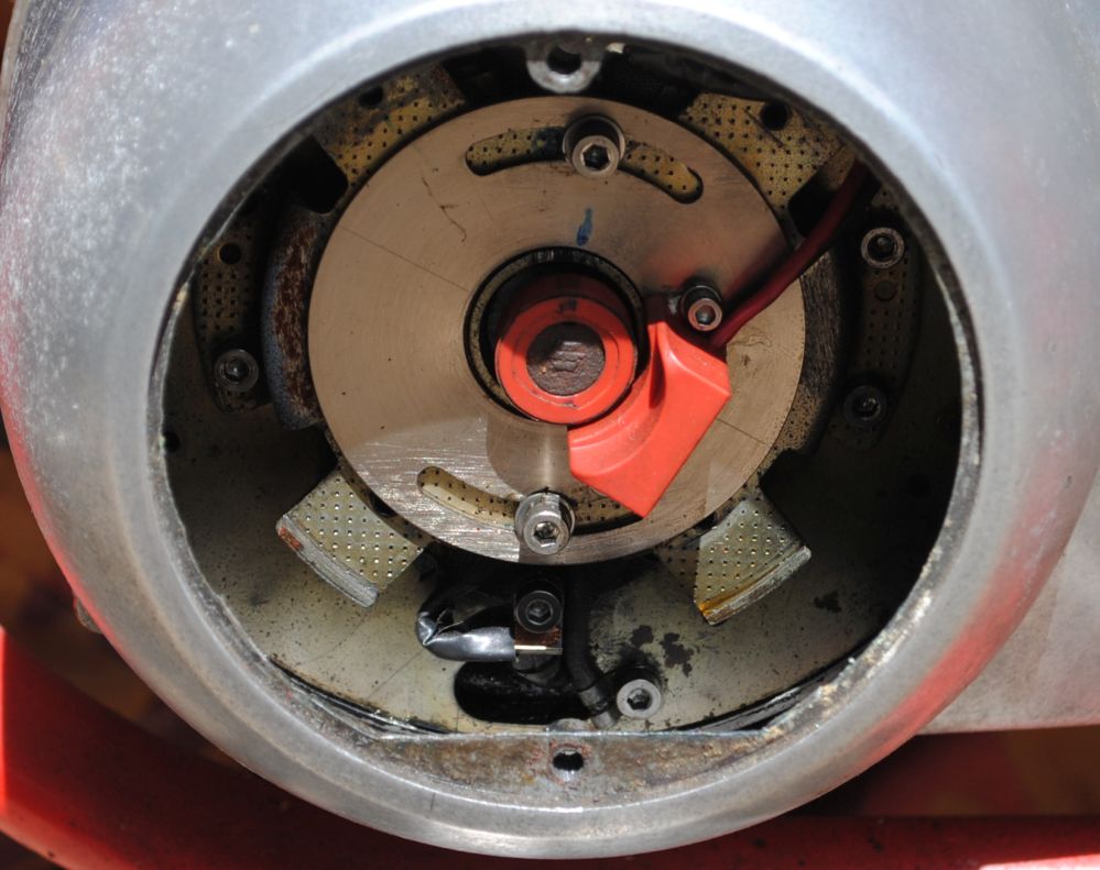

Re: Electronic ignition
i use the system below, which i adapted from a fiat 500 twin system. photo shows it on my 1965 t10 engine. also use it on all my gt250 engines. simple and cheap, i've been using this about 10 years now and only once has it ever let me down - and that was my fault
cheers, dd.
t10 ignition:
cheers, dd.
t10 ignition:
Dollydog, you are obviously a clever chap. Any chance of some more detail on the fiat system, it looks very interesting
- Posts: 349
- Joined: Thu Nov 07, 2013 1:59 pm
- Country: United Kingdom
- Suzuki 2-Strokes: A100 GT250 & 4t Yams!
- Location: Brussel County, England
There's a full thread in one of teh other sections Electrical or Tuning maybe you'll find it if you do a search. DD lists the dimensions of the backplate..
also a bit more here.. viewtopic.php?f=2&t=14710
