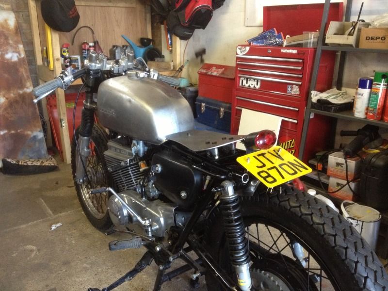

I'm in the process of customising my GT250 and I've fitted a set of dropped clip on bars. The clutch cable is now too long and the bends that are occurring are making the clutch very stiff. Is there a shorter cable from a different Suzuki that will fit?
