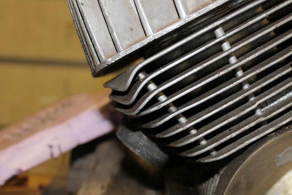

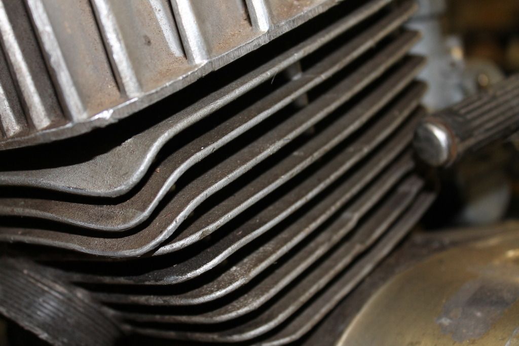

I unfortunately have three top cylinder fins - at the outer front corner - that are bent at about a 45 degree angle for a hort distance. I was thinking of annealing them -heat to ~700F, let cool. This should make it more malleable before straightening bent fins?
Anyone try this on cast aluminum fins? I have straightened fins that were bent slightly but, most of the time the fin just snaps off

I tried one fin and it seam my propane torch doesn't get it hot enough; Fin is doing its job pulling the heat away? My understanding anneal if possible is just as the point before it should melt the metal. I need a hotter torch! I did bend it back 70% of what it was. I was surprised! I went real easy and slow a little at a time.
I think the key is patience (damn and I have adult ADHD). Kind of like straightening teeth with orthodontist applied braces tentioned lightly over months versus using a pair plyers trying to do it in a couple minutes. Crack - Broke my tooth!

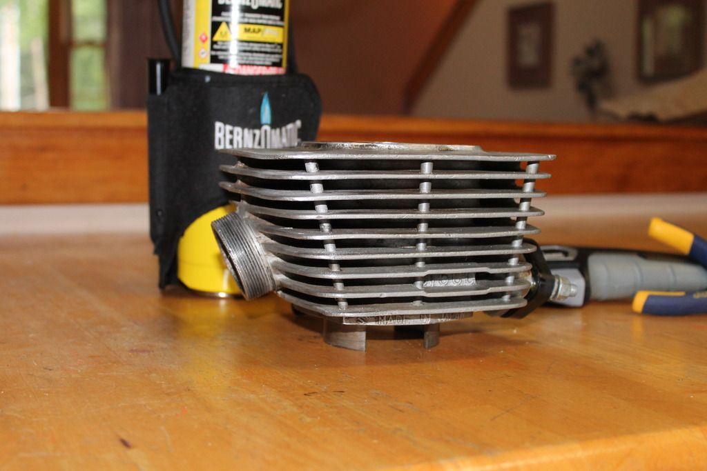

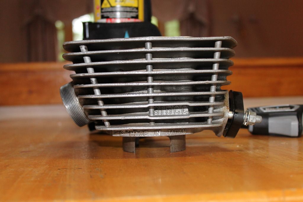

I used Map Pro propane torch versus just Propane (think this works too). Map pro is a little hotter. It will make plan soap turn black as a temperature test per “rule of thumb “ And, even if you stay on it longer (no need to though) it won’t melt the fin. Once hot, I just let a house fan blow air on it to cool. This took the most time.
As you know, if you muckle on to a fin, it will bend some, but make too much travel its snaps. That has happened to me many times. When you heat it, let it cool it bends very easy, but for a short distance and then you will feel it tighten up again. Stop at that point! Heat and cool again. The process can be repeated. I did this 4 or 5 times. Other fins in the area get soft too, but just wiggle up and down a little and it stiffens up and gets strong again. I bought a set on metal bending pliers look like needle nose but, don't come to a point and stay straight. That allows you to work it a little better. Take your time and stop when it bends harder. The process is fast and I had somewhere between 1 -2 hours into it only.
I think I got it, how to add pics like you coyote.
If I had two flat metal working pliers at the time I could have done it better. I'll pick up another and do a touch up maybe. But isn’t bad. Those three fins were laid over quite a bit and others were off and fixed them up too. I'll use aluminum brighter and all should clean up well. Got lucky this time
