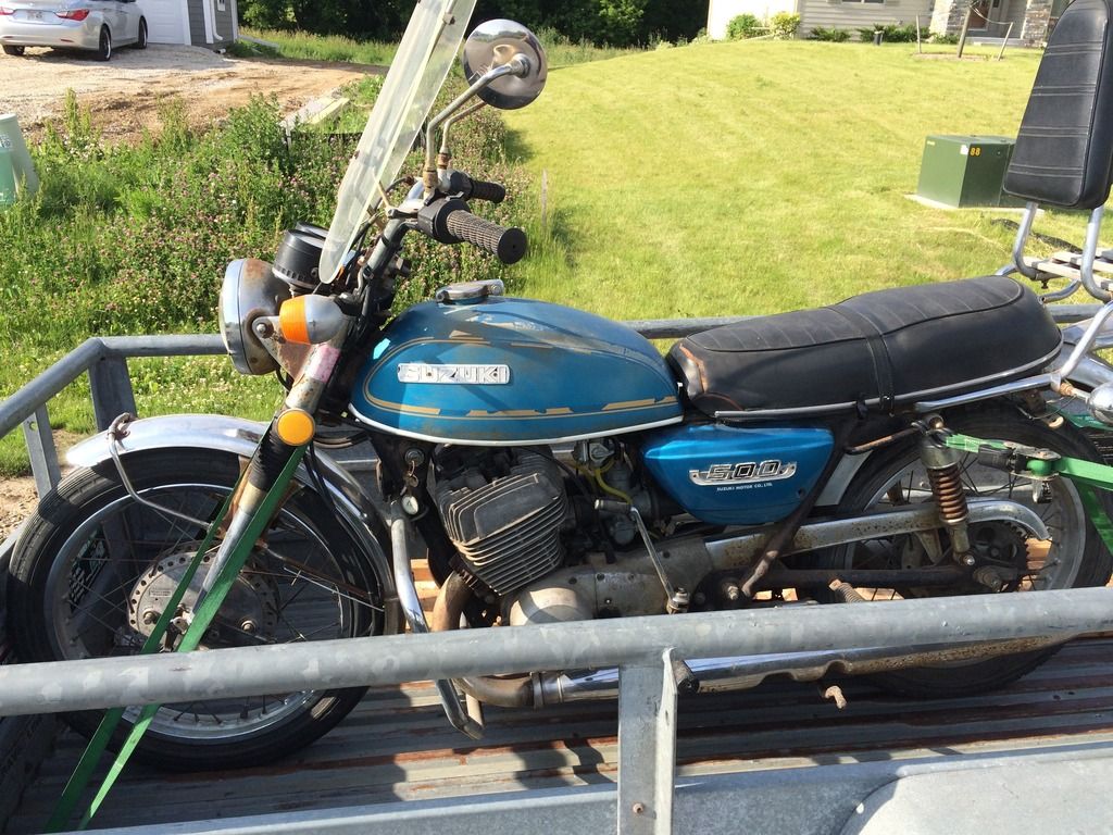

I am located in Milwaukee area. I just picked up a 1975 T500 locally and am excited to get going on my next build. I have done about 8 bikes including cafe, brat and tracker styles. This is my first 2 stroke and I am pretty excited about it.

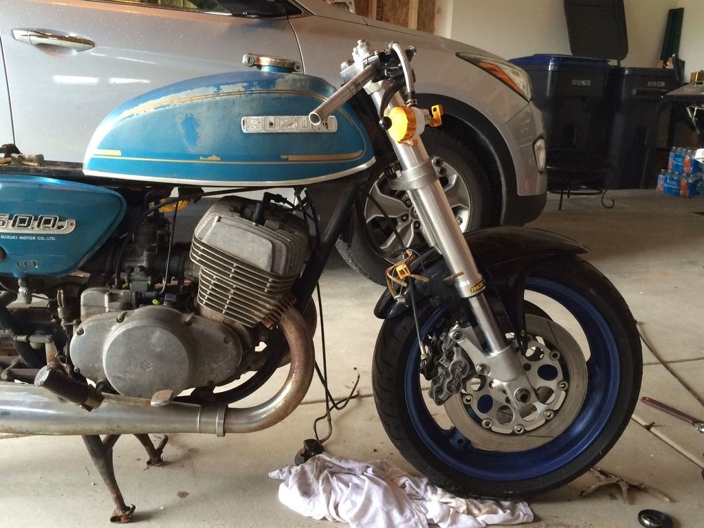

I had a question about putting a rear mag wheel on my T500. I have seen it done before (on the Higgspeed website), but I can't find specific info in regards to which rear wheels work and how the conversion is done. I would be interested in hearing about any direct wheel swaps or possibly a swingarm/ wheel direct swap.
The reason I want mag wheels on the rear is that I plan on putting a GSXR600W front end with upside down forks on the front of my T500. I want the rear wheel to more closely resemble the GSXR that I will have on front.
Here is a pic of my actual bike that I bought for $500 yesterday.

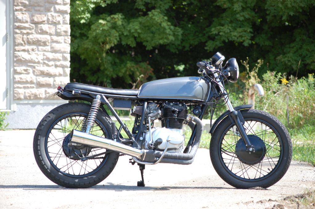

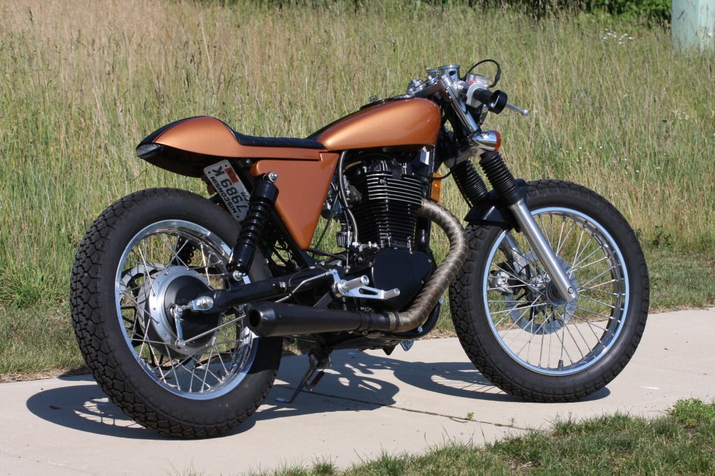

just a few quick pics of my last couple of bikes that I completed.

That's a lot of front wheel for a T500. More importantly it's probably a 3.00" rim and the rear is 1.85 or 2,15. Some of the GS wheels were 2.50". On a 750 the widest tire that will fit is a 130 IIRC and the 500 is probably similar. It's possible that you can slide a wider wheel/tire in the long T500 swingarm or a GS arm and then fit an offset sprocket

tz375 wrote:That's a lot of front wheel for a T500. More importantly it's probably a 3.00" rim and the rear is 1.85 or 2,15. Some of the GS wheels were 2.50". On a 750 the widest tire that will fit is a 130 IIRC and the 500 is probably similar. It's possible that you can slide a wider wheel/tire in the long T500 swingarm or a GS arm and then fit an offset sprocket
My plan is to find the widest rear mag wheel and swingarm combo for exactly the reasons you point out.

So I got my 1982 GS550 drum brake wheel today via fedex. Looks like it probably won't work. The rear sprocket is offset by a lot. I am not sure I could get an offset front sprocket to compensate that much. Even if I did, it looks like the chain will hit the shocks and frame anyways.
Now I am back to square one with getting a mag wheel and swingarm. At least I only paid $38 for this GS550 wheel.
I am open to ideas. I could bail altogether on the GSXR front end but I really wanted to use it. Plus, the stock T500 front end is basically trash. The forks are nasty and rusted out. The front drum is pretty bad and I would need a new rim and laces too. That is why i was hoping to use this GSXR.
I know its been mentioned that "GS" swingarm and wheel should work but there are tons of differences between years and models. I don't want to start randomly ordering different models just to try them out. Will think about it a bit, but may decide to stick with stock and simply rebuild everything.
