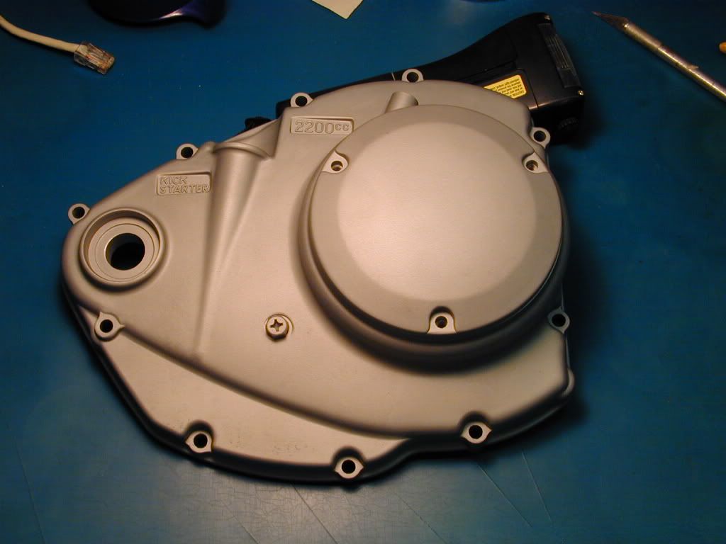

Seems to me like it would actually be better than as machined. His blast is satin smooth. Here is a cover he did off the Buffalo I had as an example of the finish.
