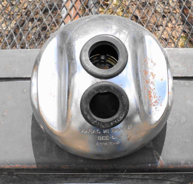

Ok guys here is the Light in question, it is a 6 inch light for sure. Does anyone know what this is from?

Looks like a GS---L series headlight.
Open it up & post a pic of the headlight backside.

The headlight bucket should be part # 51810-33600
Used on some model years of GT185 & GT380.
Those bikes came with a conventional sealed beam headlights.
Its a headlight used on several GS----L series bikes.
The L-versions of the GS bikes have smaller diameter headlights like the one you have.
Some of those bikes came with conventional sealed beam headlights & others had H4 halogen headlights.
Two examples of your headlight on eBay:
79 GS750L:
http://www.ebay.com/itm/79-Suzuki-GS-75 ... 1013915013
80 GS850L:
http://www.ebay.com/itm/80-Suzuki-GS-85 ... 1106074501
You have an H4 headlight.
The parts to compete the headlight are still available.
