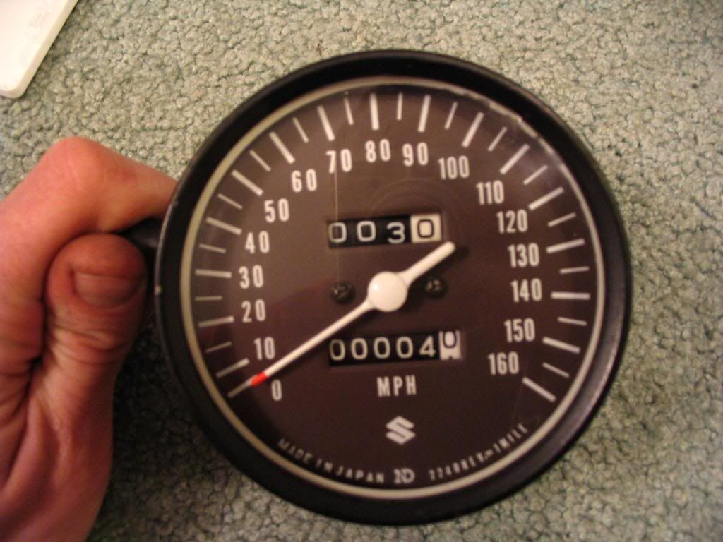

See the photo he sent to me of the gauge.

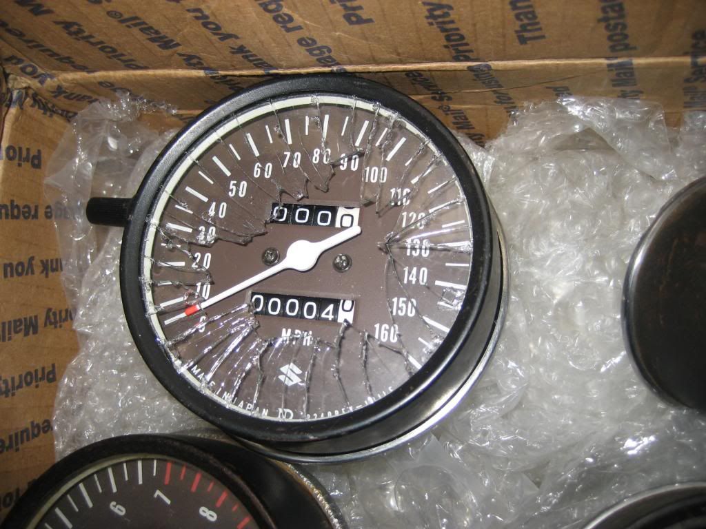

After contacting me about it, he wanted it looked at along with some other gauges for restoration. As luck would have it, only that gauge got broken in the mail package to me, but thankfully the damage was done only to the glass and not the face.

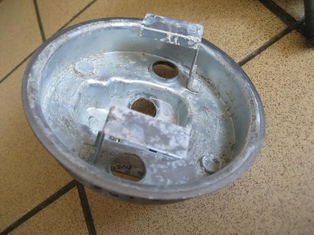

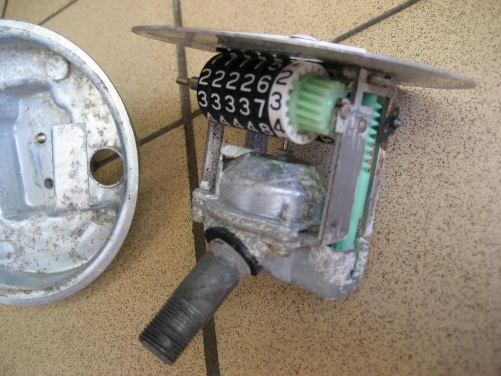

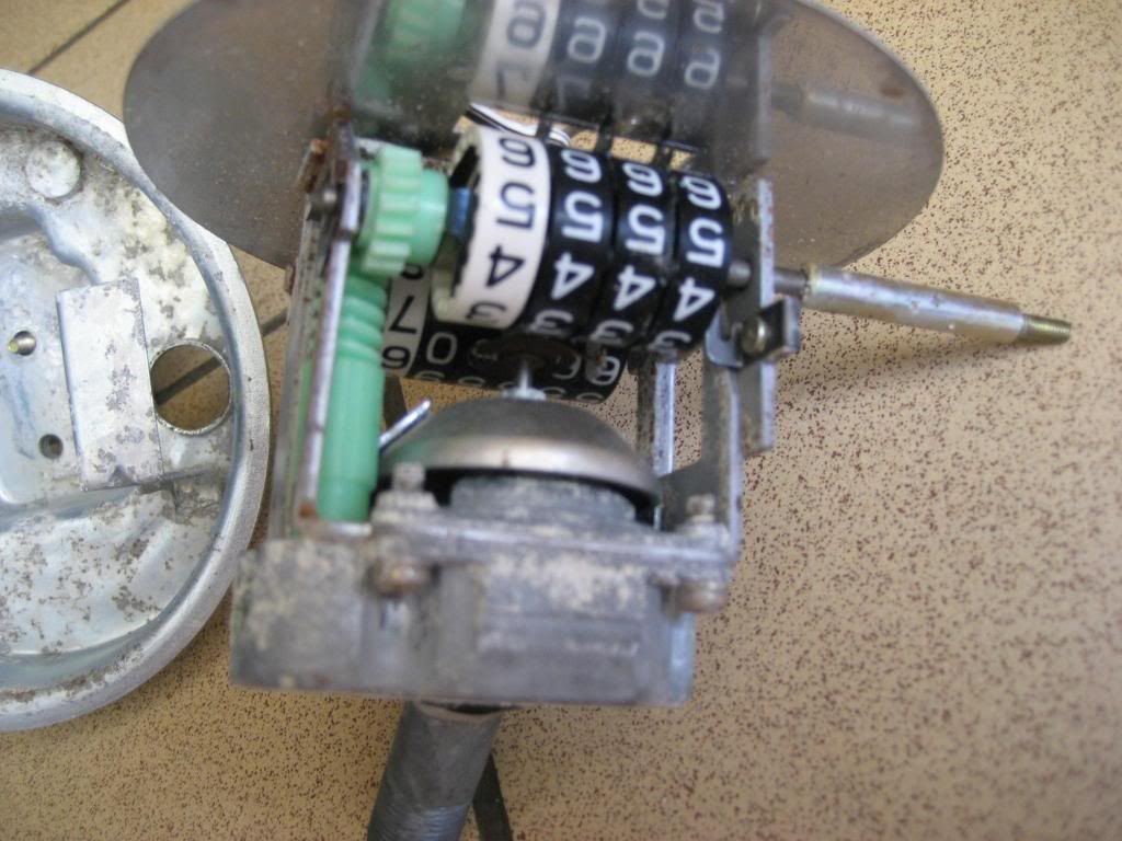

Once I had the gauge in my hand, on closer inspection I could see the gauge had been opened before in such a way most people wouldn't notice, and this was what I found inside.
Needless to say hes not happy to begin with his costly purchase and more so now about whats hes seeing inside the gauge. This whole scenario now needs to be put right to make this gauge usable again.
