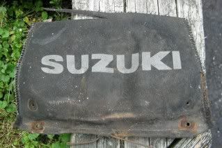

I have a 68 seat I had Sirious Consolidated reupholster many years ago. They got a similar vinyl but couldn't do the pattern in the top and there is no Suzuki logo on the back. The foam is original '68 material but is hard as a rock. I figured I would have it redone sometime in the future if I ever seriously restore the '68. So if Jug's Cobra pan is no good, I can supply one as a pattern.spike wrote:Hey juggie,
is it still good enough so we could reproduce the seat pan?
The foam shouldn't be too much of a problem if you have a repop seat cover, just alter foam until cover fits…
If Ok, I'll Pm the guy's addy in CA. They would be reproduced in metal.
But here's the thing - looking at the Cobra tank versus a later T500 tank and looking at the Cobra seat versus a later T500 seat - I think the pans are close enough where you could use a later T500 seat for a Cobra. You might have to tweak the mounts with a hammer to get it just right. And I know the foam was a different color and I think a different shape.
So it's my *opinion* the seat pans are relatively similar however every time I offer this up I'm told by others that they are different because the Cobra tank is a different length than the later tanks. I have a 68 tank hanging side by side on my shop wall with a 69, a 70, a 71, etc.... They are all hung at the same height and *LOOK* to be the same length.
I'll take a tape measure to seat pans, tanks, and frames this weekend so I can either find out I am wrong or confirm my opinion as fact and post some pictures of what I find.
So, my seat pan could be used as a pattern if Juggie's is not available but there may not be a need to reproduce the pans.
Fresh, supportive, preshaped seat foam however would be nice to replace the rock hard foam that's on my seat now.
Sirious preserved my aged but intact seat cover when they reupholstered my seat and returned it to me but with reproductions available, it seems silly to reinvent the wheel:

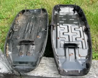

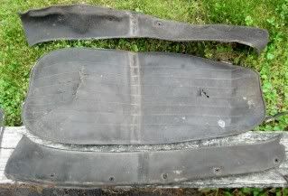

Well they say you only stop learning when you die and serious study of a Cobra pan versus a '75 pan was somewhat educational! Here's what I found:
the 75 pan is on the left and the Cobra pan on the right in these first two pictures
The 68 pan has a different ribbing structure and rises up towards the rider in the front and kicks down away from the rider in the back. The later pan kicks up less towards the rider in the front and is flat in the back.
The mounts ARE almost the same distance apart but the bent rear on the later pan alters how the mounts meet the frame.
You can see the seats look about the same length although the foam is shaped differently due to the pan shapes

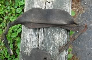

I have the original seat cover in pieces back from Sirious but better repros means I probably won't need to ship it off to anybody
I also noticed there are a couple of rust through holes in my seat pan towards the front. Nothing that would render it unusable but I don't know the requirements of your repro maker. If it would help folks out, I'm up for sending it to someone to repro.
Jim

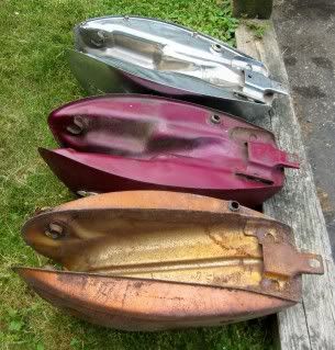

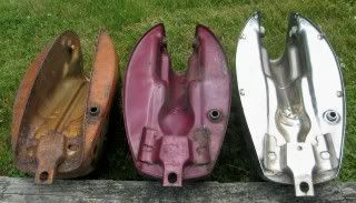

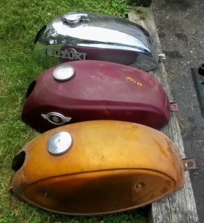

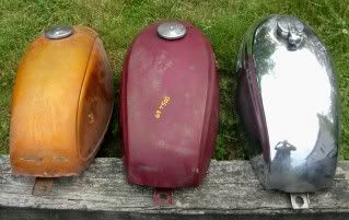

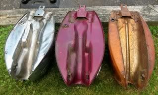

And as for tanks, here's a Cobra tank next to a '69 next to a '75 tank:
The Cobra tank is the orange/gold (and rust!) color, the 69 is purple, and the '75 tank is chromed.
Again, I was surprised to see how different the 68 inner structure was from the 69 and later tanks. I didn't realize how big the tunnel is in the '68 tank. I wonder why Suzuki made it so large?
Notice the tanks are all about the same length and the mounting points look close to the same. The '68 tank IS narrower but I imagine the chrome side panels and rubber knee pads make it a bit wider.
Jim
