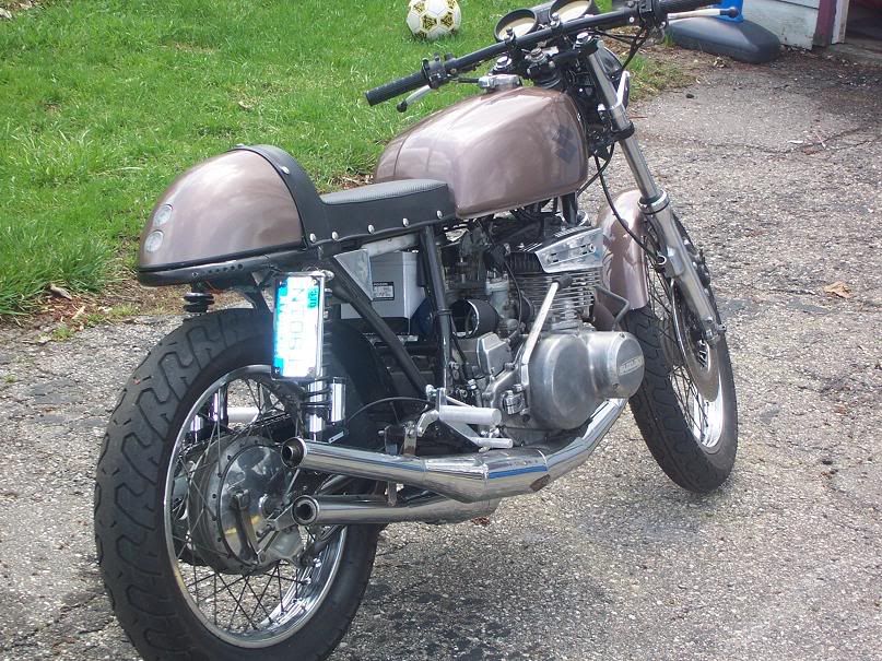

This is as they looks...the pegs and the whole bike in his latest version.
If you look well, you could see also my "trullo" reflected into the tank :-)
'75 GT380M
'77 GT380B
'77 TS400B
('74 GT380 is gone at 2300 euros)
Rocky,
that is the cleanest drive chain & sprockets I have seen for a LONG time :)
I also love those A-spec front mudguards, they look so good.

That pic of the 380, which is superb by the way, helps a little, but can i get a pic of the foot peg itself. if it has the squared notch on peg and frame, it will work. thanks for the help guys.

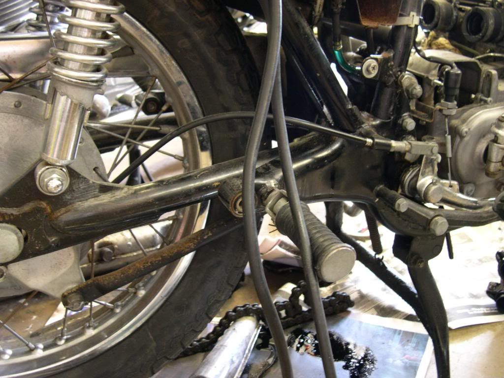

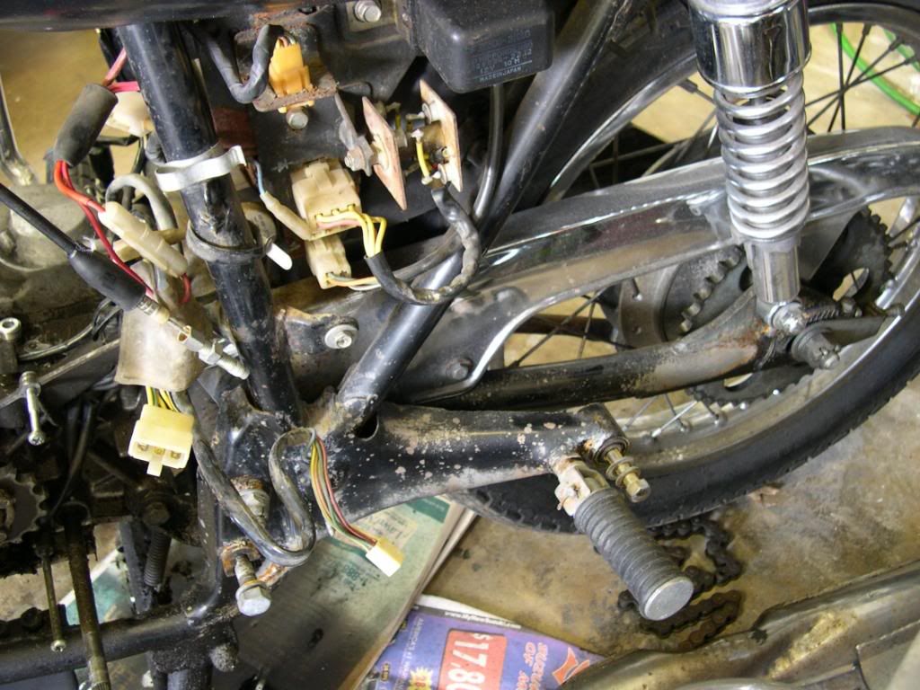

75 GT380
See if this helps you any.
This one does have the notched peg and frame, better seen in the second photo.

That means that my rear set design will work with all models 73 and later. Good to know. Thanks guys for you input.

Chain and sprocket were cleaned right then...a costly Regina chain DOES need some further attentions.
The front fender comes from a GS450...only seen on the GT380C model also, maybe never seen out of Japan, a simply bolt on job, I like how it enlight the bike's front end. Dont' you, Craig? :wink:
