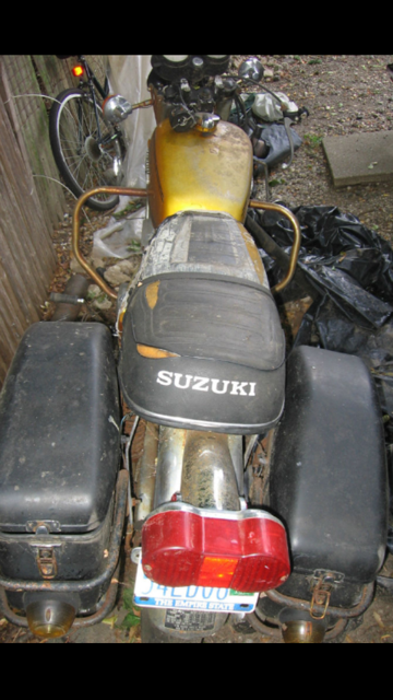

Here they are:
As you can see they are not that big.
Came off this disaster
So far the electrolysis worked, I scrubbed off the rust and paint, and the chrome is pitted. So I decided to spray the metal with high temp BBQ paint to prevent flash rust, and eventually I will spray it down with black truck bedliner as it will hide the imperfections and I personally like the way it looks.
The saddlebags themselves I took apart (PITA) and I drilled out the rivets, cleaned up the rear hardware and got new matching latches for the front. Ill eventually spray the bags with the PlastiDip or im thinking of doing the roll and tip painting method as winter is here and it's too cold to spray paint anything right now.
